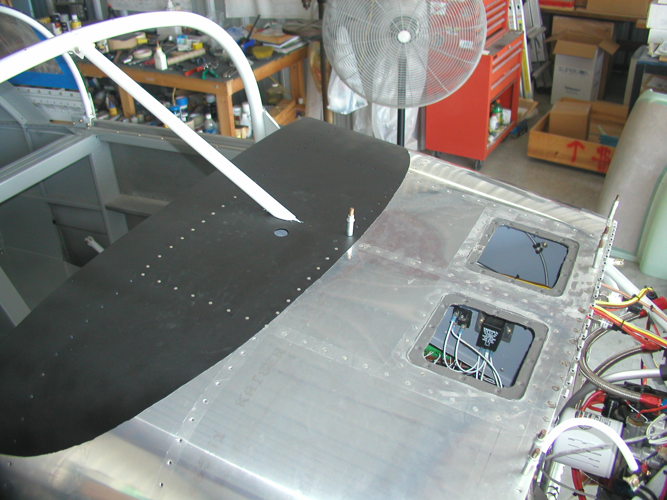

bobbyhester(at)newwavecom Guest
Posted: Wed Sep 23, 2009 3:20 am Post subject: Inspection Plate |
Yes I did. Yes it did leak but not after using a sealant just recently, I picked it up at the auto parts store it was not RTV but is something that does not harden, I put a small amount around it and installed it. Washed the aircraft (the only time I noticed it leak) an it did not leak.
David Schaefer wrote: | Quote: | Has anyone in the 6 or 7 community cut 'inspection' plates into the forward coweling just ahead of the windshield for access to that area? If so I'd love to see pictures, how you did it, does it leak etc? Please contact me off-line.

walter(at)tondu.com Guest
Posted: Wed Sep 23, 2009 6:14 am Post subject: Inspection Plate |
Hi David,
See entries dated 6/26/04 on this page: http://rv7-a.com/tipup_canopy_2.htmWould I do it again? Yes. Doesn't leak either.

bmeyette
Joined: 14 Mar 2007 Posts: 72 Location: Cornish, NH
Posted: Wed Sep 23, 2009 8:53 am Post subject: Inspection Plate |
Hi Walter,
I see you made yours with the panels laid out flat. I've done flat access panels before, but haven't tried doing yet on this piece that will be installed with the panel curved. So you just did yours laid out flat? No problems with that? I had figured that, if I did it flat (MUCH easier than trying to do it in place curved), the panel and the sheet would bend differently and result in opening the gap between the panel and the opening. Not an issue for you?
brian
Posted: Wed Sep 23, 2009 11:17 am Post subject: Inspection Plate |
The area in which I located the panels is very flat and so itdid not have any impact. If you build 4 inspection panels as
some have done (two additional panels outboard) then that
*might* be an issue in which case you would want to measure
and drill with the skin in-place.

For my 8A, I think I remember that I had some material trimmed off the forward top skin that had exactly the right curve in it, or possibly I rolled the curve myself. Either way, it fit the curved surface quite well.
Terry

http://blog.bowenaero.com/?p=38
Above are some notes on access panels I did on the RV-8. No memorable problems with water leaks in during washing or flying. Otherwise is was hangered or covered. I may do the same on the RV-7 tip-up....not sure yet.
Larry Bowen

That sure looks familiar, Larry. I think I must have copied yours.
Terry

The only way I knew that mine leaked was because I have the brain box for my engine monitor under one of those and after I washed the aircraft my engine monitor would not work properly until it dried out. I never saw any water so it was very little. After sealing, it no longer leaks. They are very need on my plane, and glad I did it.
Bobby Hester wrote: [quote] Yes I did. Yes it did leak but not after using a sealant just recently, I picked it up at the auto parts store it was not RTV but is something that does not harden, I put a small amount around it and installed it. Washed the aircraft (the only time I noticed it leak) an it did not leak.
