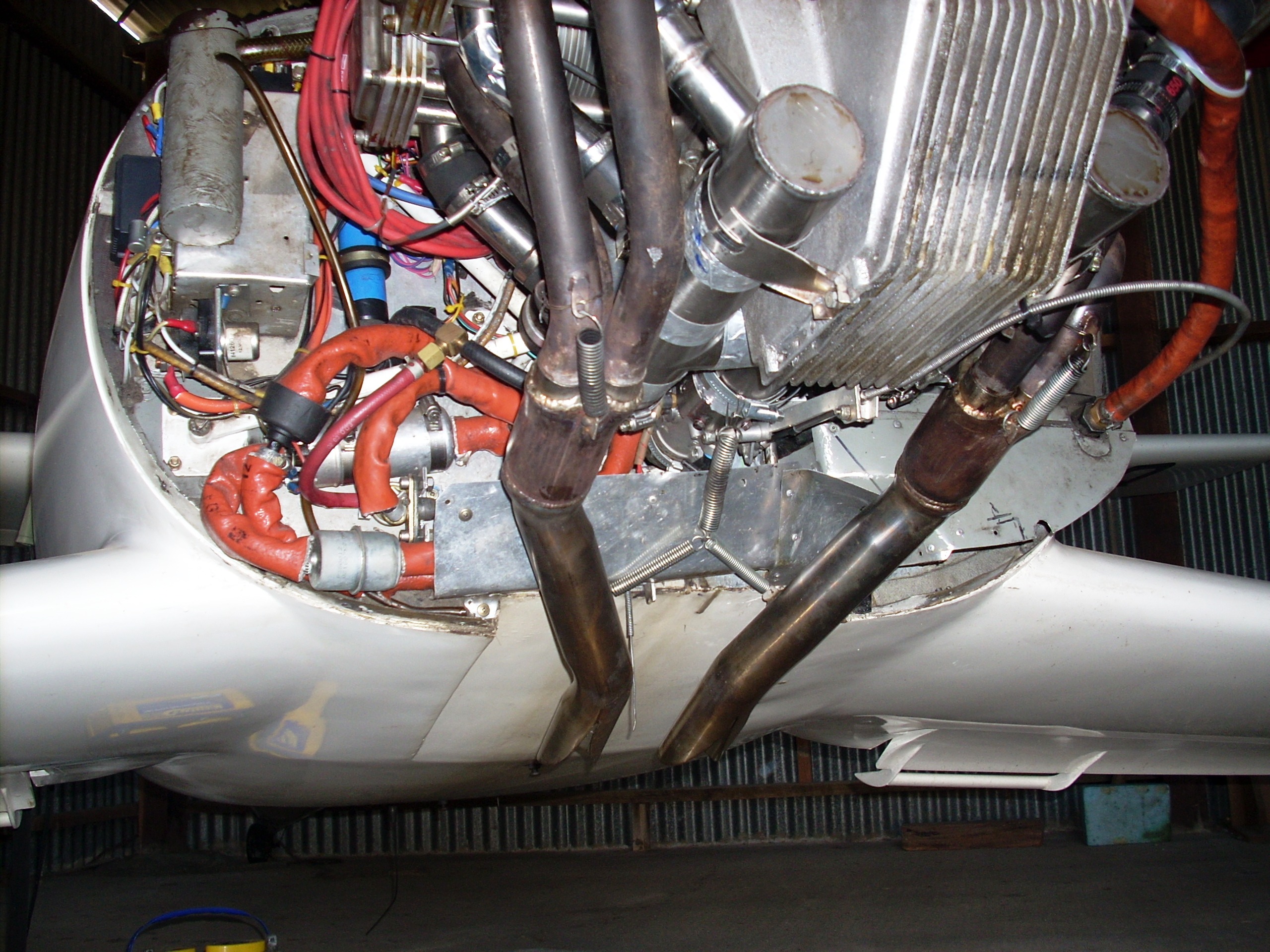

The first pic attached was my first attempt to make a new induction system
using off the shelf SS bends and Tees.
It was a failure because it is too big.
Manifold pressure hovered close to 1 atmosphere and although the engine
would run it was about impossible to tune and was very sluggish.

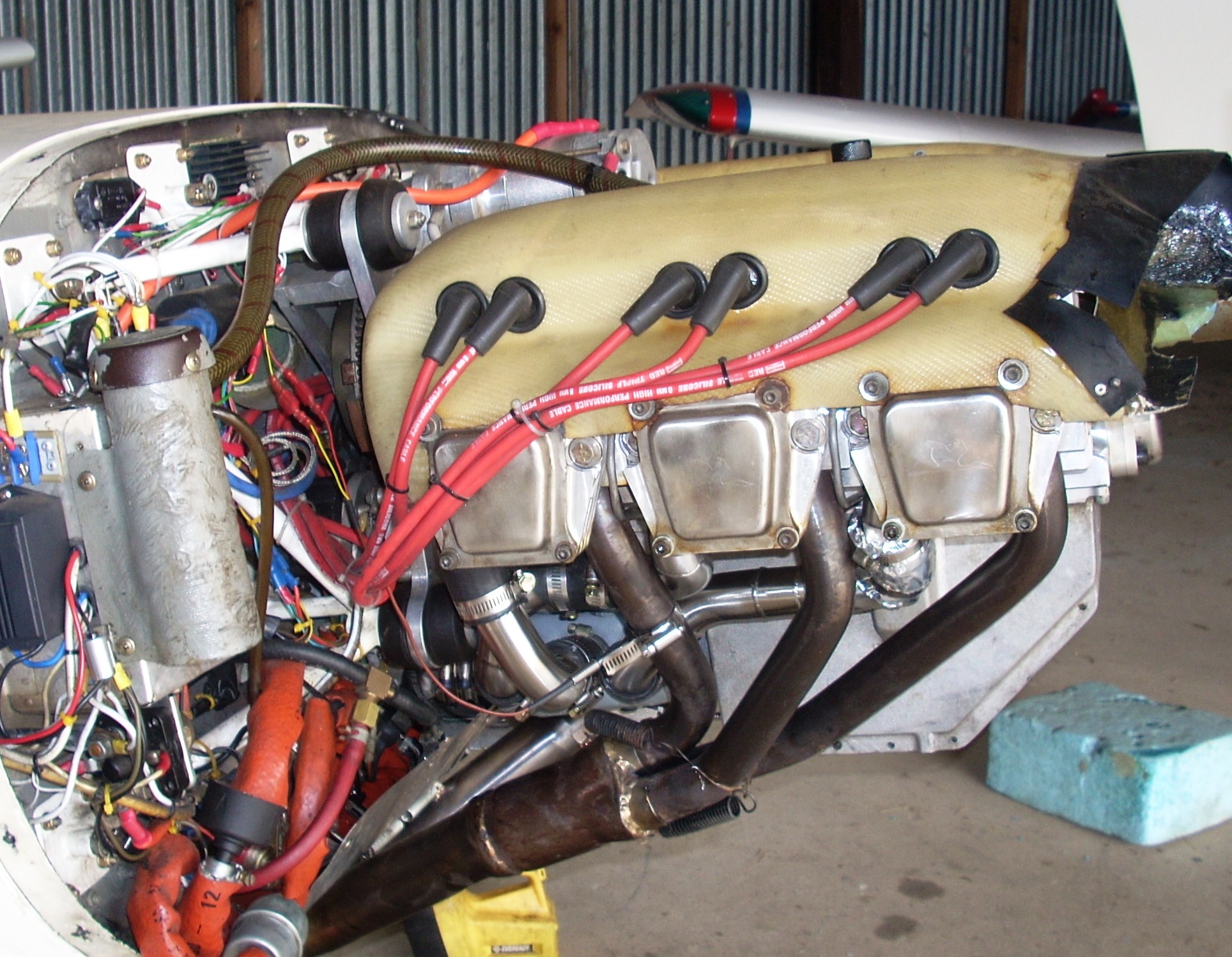

The second pic shows a system that works OK but I started out to make it for
equal pipes. Working on hands and knees on the hangar floor is too hard. I
got 4 equal and two less than equal but it works fine.
Again using available SS bends I cut and fit each section then taped it with
packaging tape. When each section was complete I removed it and got it TIG
welded.
It would be possible to make all 6 equal but not the way I did it.
I am not sure it would make much difference to EGT spread because the pipes
are not going to be all the same shape, consequently next time I would use
the head section of the existing intake pipes and make up connecting
sections to the plenum. I think the way forward is to make an updraft plenum
with symmetrical outlets much like Pete.
I found a source for the SS bends at cost about AUD9.00 each if you need it
let me know.
Peter

PostPosted: Tue Sep 15, 2009 9:10 pm    Post subject: REFIT INTAKE PIPES Reply with quote
Lynn the first pic which shows two separate "headers" was a failure because
it was too big.
The second pic uses headers closer to the original setup and it works fine.
My plenum which relates to pic 2 was only about 1L.
I think the rule of thumb referred by Andy probably means "including the
capacity of the headers"
As I posted before I could not get a low enough vac pressure for
satisfactory running of the dual header setup.
The dual header setup could be made smaller and it lends itself to dual
throttle bodies.
Based on what I have done so far I am going to stay with the single throttle
body and a symmetrical plenum of not more than 2L.
Yes I think you can retain the upper part of each header and adapt the ends
to suit the plenum.
Peter
