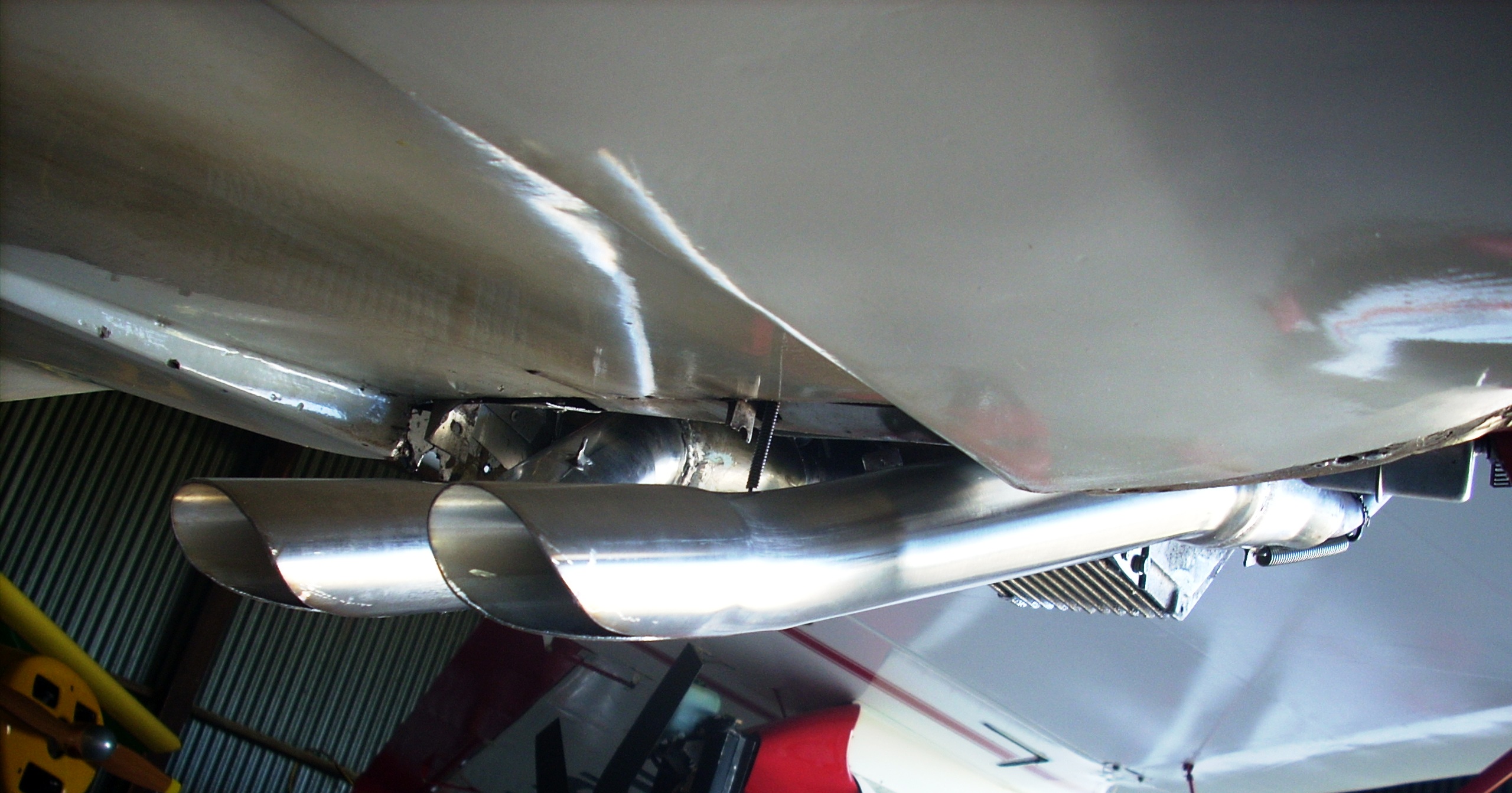

Pete D has made a beautiful symmetrical updraft plenum close to
what I have
in mind.
To make space for my (end fed) plenum I have removed the silencer.
I used the NACA principle to shape the pipe ends and this has
softened the
exhaust note and theoretically reduced exhaust back pressure.
Without a balance pipe it beats a little but they say it sounds
like a V8.

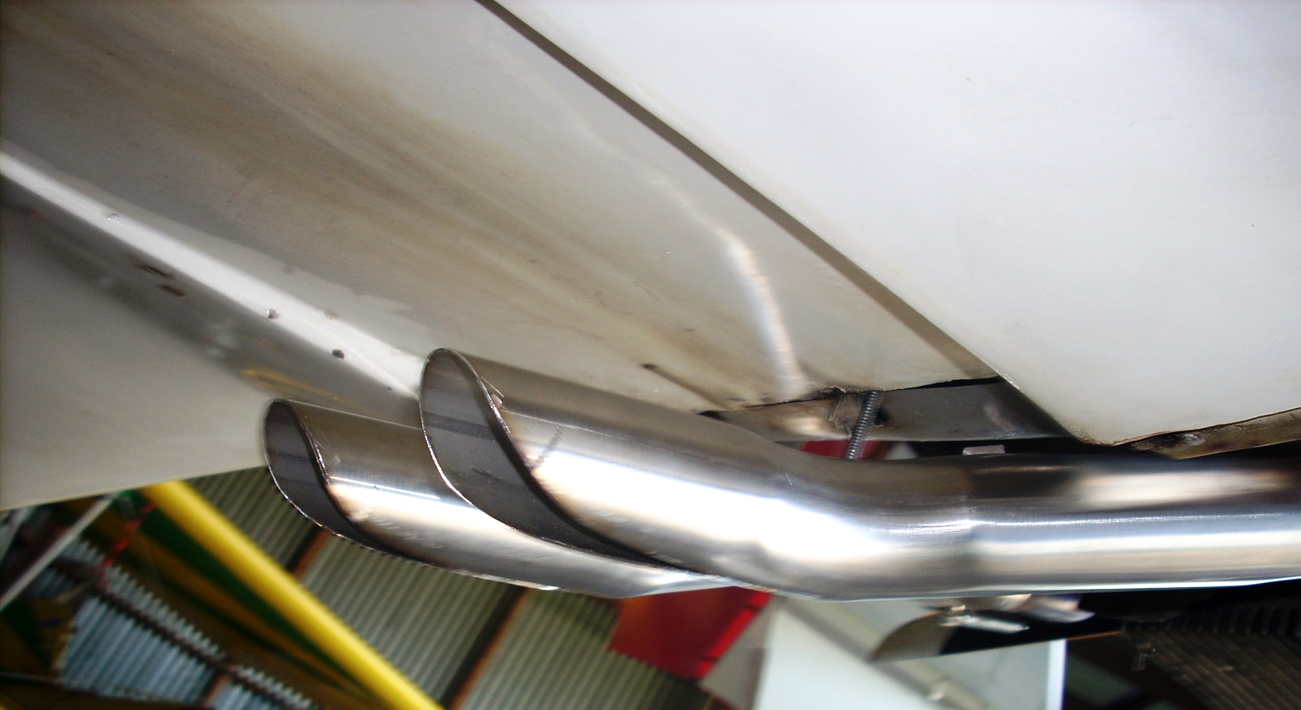

Lynn,
I have attached a pic of the modified tail pipes. You will be familiar with
the shape. There is a progressive reduction in pressure as the exhaust
progresses out the pipe. This eliminates the "bark" and should make for
reduced back pressure. It was one of those ideas you get in the middle of
the night. (Normally this NACA shape is used as an air inlet)
I found it softened the tone and is comfortable noise level in flight.
I will look into the Rotec but at present I am running fuel injection with a
Jenvey throttle body.
The Aerocarb suffers from basic design faults because of the offset leverage
from the cable attachment. At low throttle settings it can jam and the
harder you pull the cable the harder it jams.
Peter

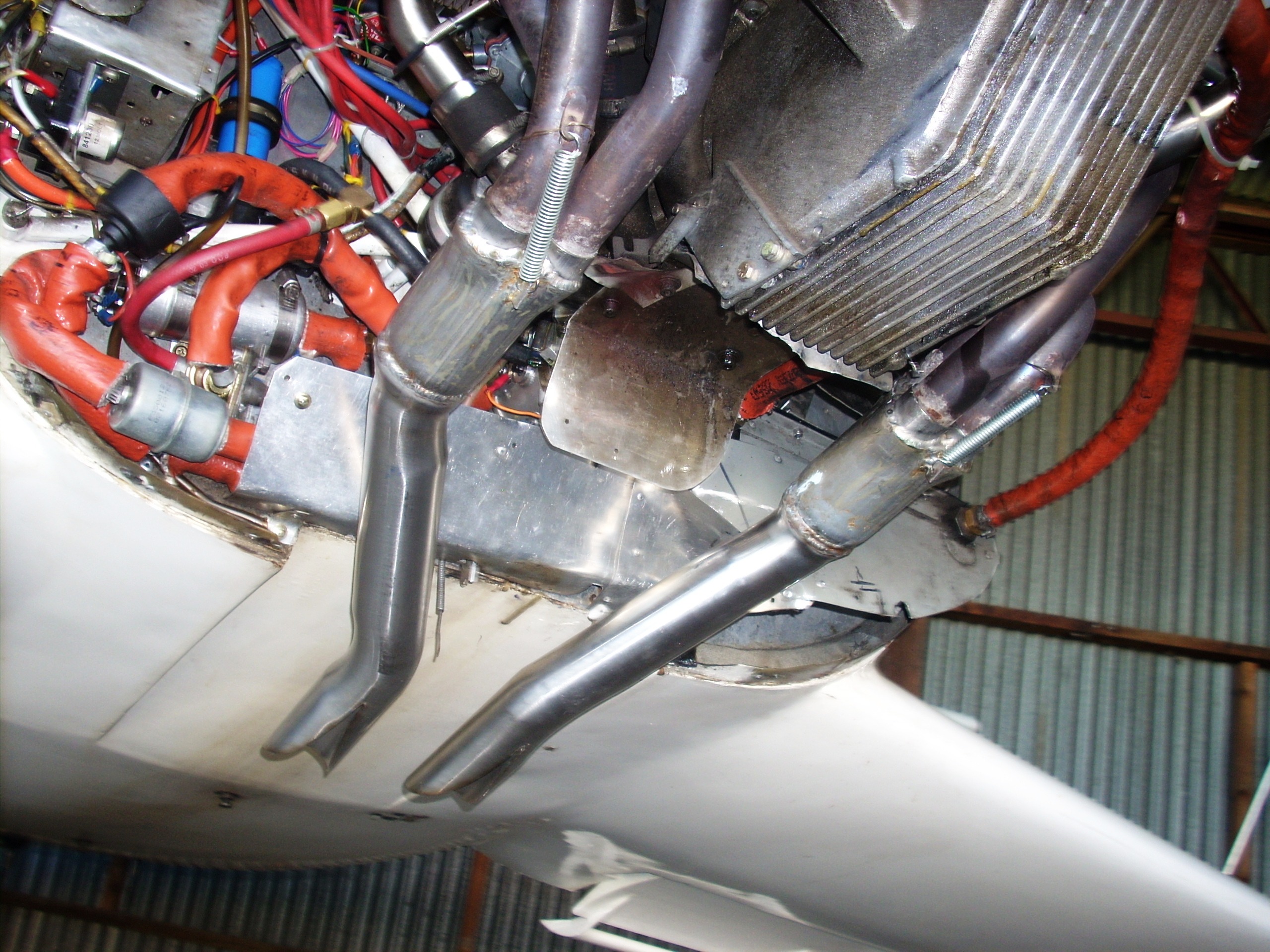

Pete, that looks an interesting idea, do you have a picture from a
different angle?
I have a single down pipe on my 3300 and there's a 2200 at the field,
they are both noisy in comparison with the twin pipe engines, if this
style of outlet reduces the 'bark' I'll change it on mine.
I have my 2200 pipes cut at an angle and that's really quiet, I didn't
do it for the noise rather to stop the floor from getting so
warm....pipe were very short.
Regards, Clive

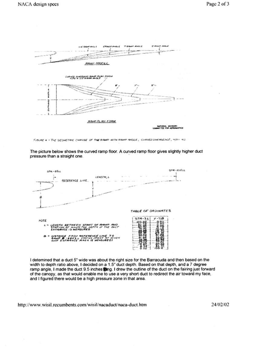

I have only the three pics attached but here also is a paper on NACA inlet
design.
Using a felt pen on the pipes and an angle grinder I just made it look like
a NACA inlet.
Peter

Are your pipes made of aluminum? They look like it...at least from
the collector to the NACA cut.

PostPosted: Wed Sep 09, 2009 8:54 pm    Post subject: Here's an idea that DIDN'T work Reply with quote
That's great thanks Pete, felt pen and grinder and I'm off to the
hangar!
If nothing else they look really trendy!
Will match the 4 Naca scoops I have on the new cowling.

PostPosted: Wed Sep 09, 2009 10:38 pm    Post subject: Here's an idea that DIDN'T work Reply with quote
Lynn they are Stainless steel.
