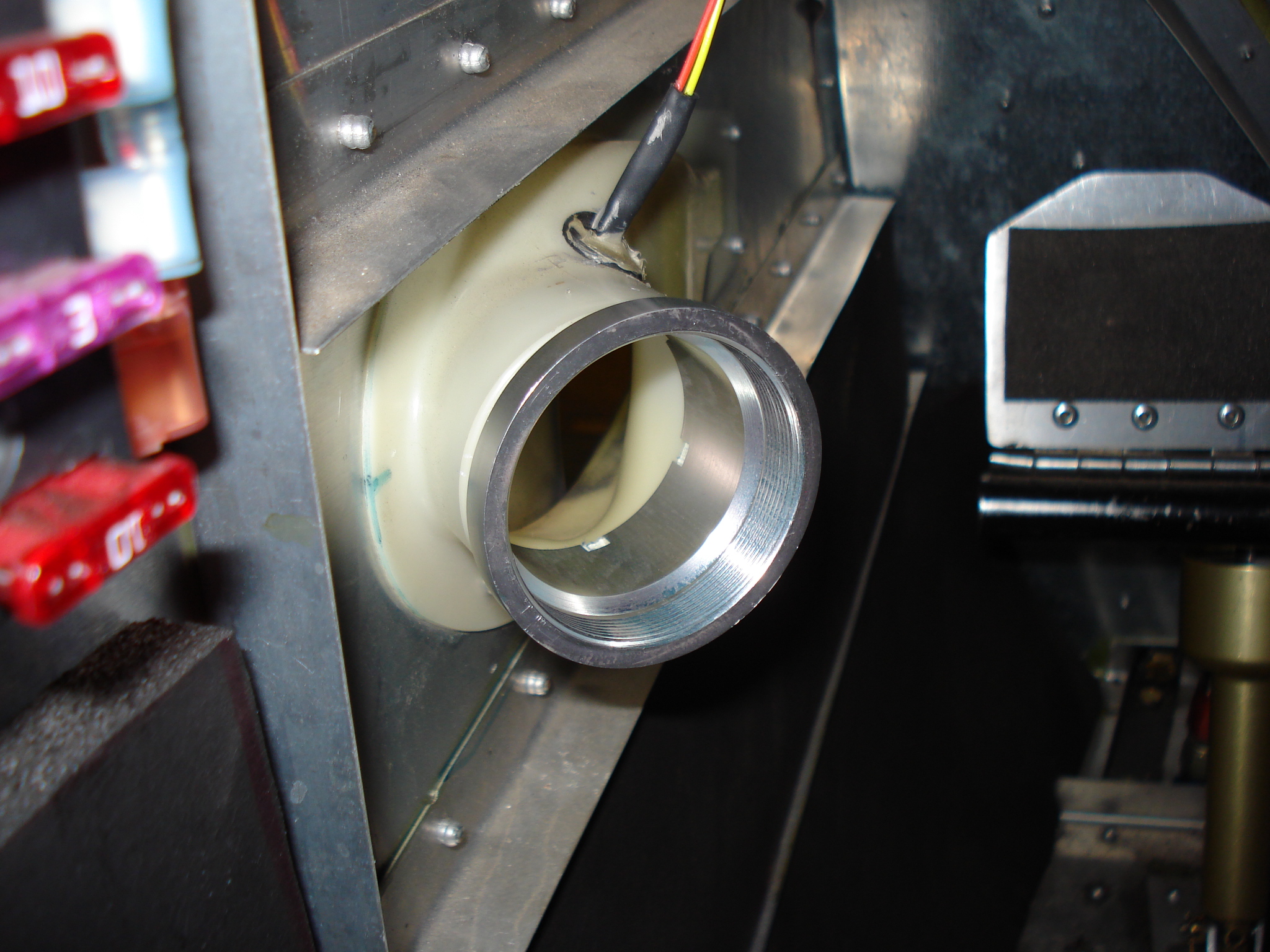

PostPosted: Tue Sep 08, 2009 2:53 pm    Post subject: Duct reducer Reply with quote
Hi, Bill.
The best solution I've found is to stick an AveoAir ball vent directly in the NACA duct outlet. The 1.75" OD (also available in 1.5 and 2.0) nests quite nicely, and only needs a bead of RTV or a layer of gaffer's tape to be snug and airtight.
Or, you can get the vent with the 2.0" sleeve, and some SCAT, and be done with it!
Rick Lindstrom

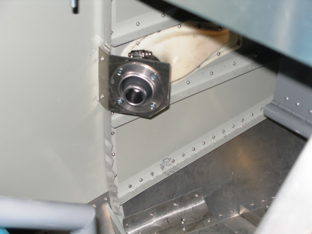

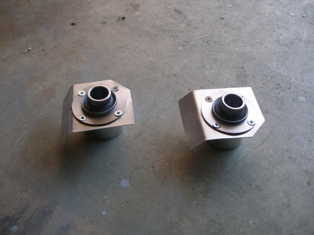

jaybannist(at)cs.com
PostPosted: Tue Sep 08, 2009 4:53 pm    Post subject: Duct reducer Reply with quote
Bill,
No need for duct at all. Just fab a few pieces and fasten the eyeball directly to the NACA outlet. I think I used .062" for the face bracket and .025" for the transition piece.
Jay Bannister

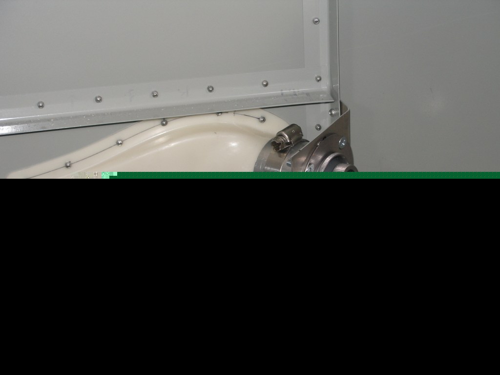

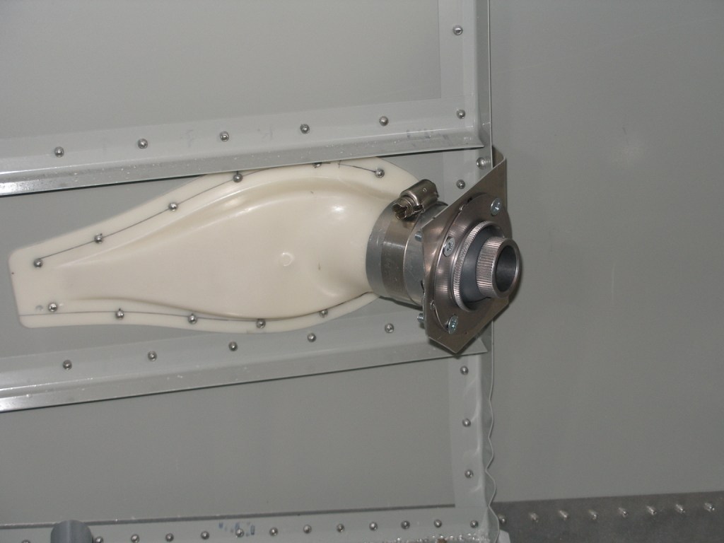

naumuk(at)windstream.net
PostPosted: Wed Sep 09, 2009 7:19 am    Post subject: Duct reducer Reply with quote
Jay,Rick and Gerry-
I installed my eyeball vents in my panel so at this point, I can't direct couple the vents and NACA scoop. Also, I mounted the NACA vents higher up, in the space between the upper longeron and upper L angle brace. My reasoning was to (1) keep the length of vent tubing to a minimum, (2) provide easy access when the top front skin was removed, and (3) leave as little as possible hanging in the "Foot tunnel" to be kicked off by an excited passenger. (Or pilot, for that matter)!
With only 1/4" difference between the NACA scoop and eyeball vent ODs to compensate for, I can either remove some of the wire as suggested by Gerry or build up the OD of the eyeball vent using 1/16" rubber or foam. I'll make up my mind after the vent tubing comes in from ACS. Thanks for your input.
