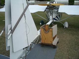

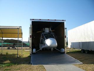

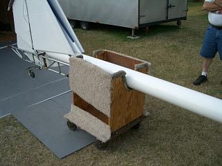

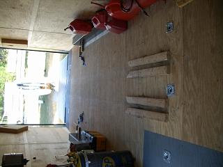

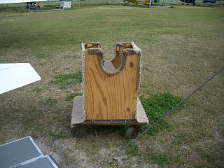

Trucks are firm riding.I would try to find a trailer. A car hauler is easy to adapt.I'll send you some pictures that may give you some ideas.

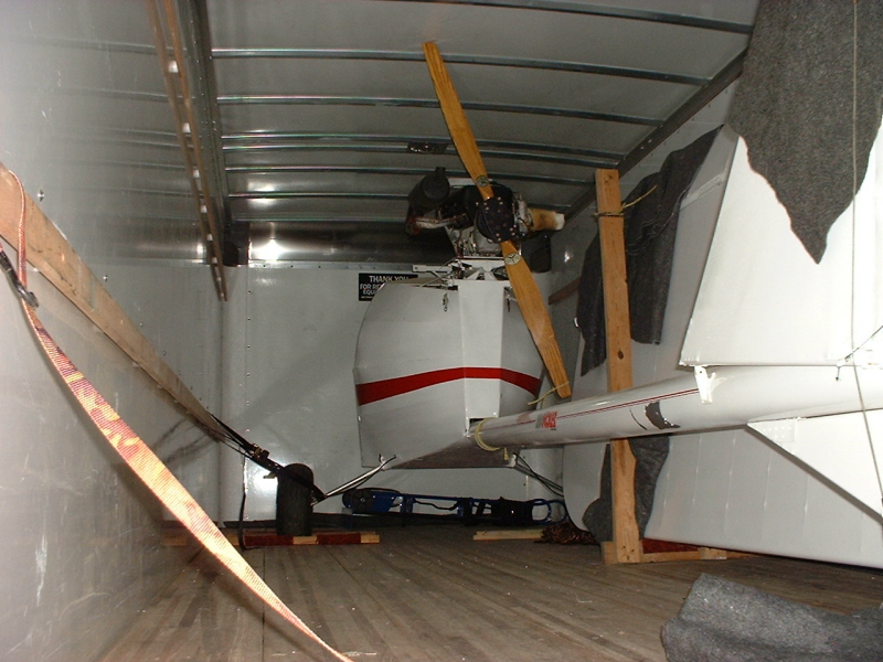

I rented a 26 foot Pennske truck to get my Mark II from northern Alabama to southeast Georgia, about an 8 or 9 hour trip.
The man I bought the plane from had some homemade wood wing holders padded with carpet, and we also padded it with extra moving blankets. I believe we strapped the wings to the side wall as well.
We nailed some boards into the floor on both sides of the tires (don't know if we were supposed to do that to the truck, but it had a wood floor and we removed it after we were done). As you can see in the picture we used rachet straps wrapped around the board that runs along the side of the truck wall to help stabilize it.
We put foam in between the horizontal and vertical stabilizer while it was folded up, but we missed a spot and the only damage I had to the entire plane after the move was a small hole in my horizontal stabilizer.
The other ideas already mentioned from others would be a good thing to incorporate if you decide to go with the Uhaul truck.
By the way I had four men to lift the plane in and out of the truck. My Mark II is about 400 pounds.
