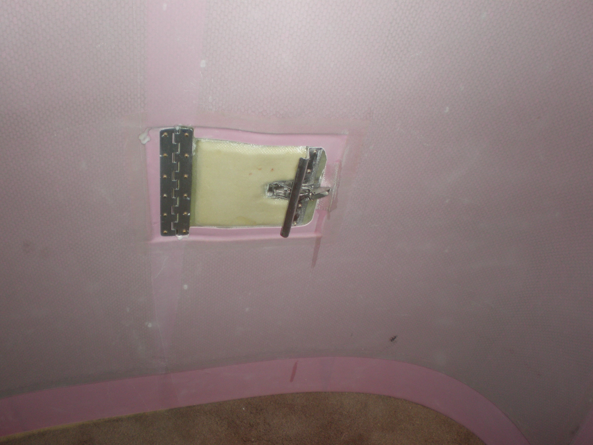

PostPosted: Mon Aug 17, 2009 4:26 am    Post subject: Oil door hidden hinge Reply with quote
Added some extra glass and a Z-bar stiffener and it seems to work well.
Should have taken the time for the 100% hidden door, but at least it is flush and do not have the do-hickers sticking up.
Oil door
