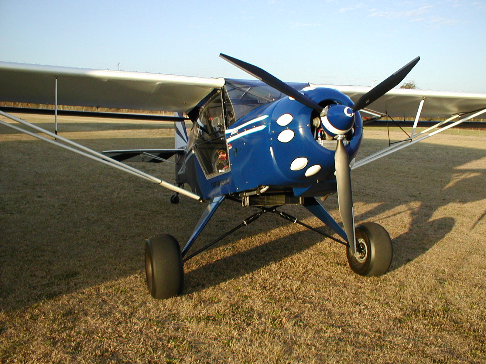

Well, it has finally happened to me. I have read about this problem happening to a few members and now I witnessed it.
My Kitfox had not flown in about two weeks so I decided to fly it yesterday. I checked the oil quantity and of course it was below the dipstick (as usually happens when the aircraft sits for a while) I started turning the prop thru its normal ritual when I noticed one of the cylinders had no compression. Great, now what do I do. Well, the tank had not  "burped " so I continued turning the prop and eventually the compression came back on the one cylinder and I flew the aircraft. The engine performed fine.
I am assuming I had a stuck valve and it "unstuck" itself. I have been using 87 auto fuel with no alcohol. No avgas has been in the engine. The 912 UL has 210 hrs since new. The only thing I have done differently recently (I know this is sacrilege) is added Marvel to the fuel, along with fuel stabilizer. I have read and talked to people that have had this problem in the 912 and they have indicated that Marvel seemed to help with sticking valves and that is why I started adding it to the fuel. I used it in my Pacer and prior aircraft with no problems. I have had problems in the past with sticking valves until I used the Marvel (specifically a Cessna 120 which ended up with a stuck valve and bent pushrod)
My plan of attack now, is to try and rotate the prop every day whether I fly or not in order to move the offending valve.
If this happens again and the compression loss does not "fix itself" should I run the engine or not? Did the addition of Marvel loosen carbon sticking it in the valve guide? Should I not use it? I personally think it probably had no effect at all on the valve sticking.
Any ideas would be greatly appreciated. I know this has happened quite a few times to other guys with there 912's. My oil temp has been running about 190-200 in cruise and coolant temp about 185.

My Kitfox sits high on smaller bushwheels. The oil tank is above the engine and is fixed as low as it will go. The oil siphons back into the engine case as it sits until it goes below the dip stick (over a few weeks) When I "burp 'the engine it is all full again. If I were to put more oil in, oh boy what a mess !!!
I really don't know how far it drains down. I suspect if I lifted the tail up to where the tail is level I would see some oil on the dipstick. If it drained all the oil into the crank case I am sure I would have a massive hydraulic lock (which I haven't)
I have asked this same question on the Kitfox forum many times and no one has an answer. (they have it too)
My oil filter contaminant and oil analysis checks have all been normal. If there was any abnormal cam wear I am sure it would show up. I have done the lifter check many times and it is all normal.
The plane was built in 2002 so has had many years to develop a problem over this but hasn't so I guess at some point the siphon stops.
