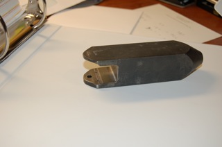

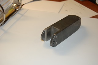

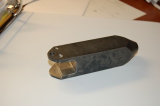

PostPosted: Tue Jul 21, 2009 9:12 am    Post subject: Rudder Rivet Question Reply with quote
The bucking bar pictured below from Avery is a very useful tool. Aside from letting you dimple hard to access areas with your rivet gun, a simple modification will allow you to set rivets in tight places. I ground out a chunk of the bar as you can see in the attached pictures. It gives you a very strong, but thin surface to slide in to those tight spaces and set rivets against. I also counter sunk a couple of holes that, when push comes to shove, can be used with a rivet and gun to dimple holes in very tight spots.
Jeff Carpenter
