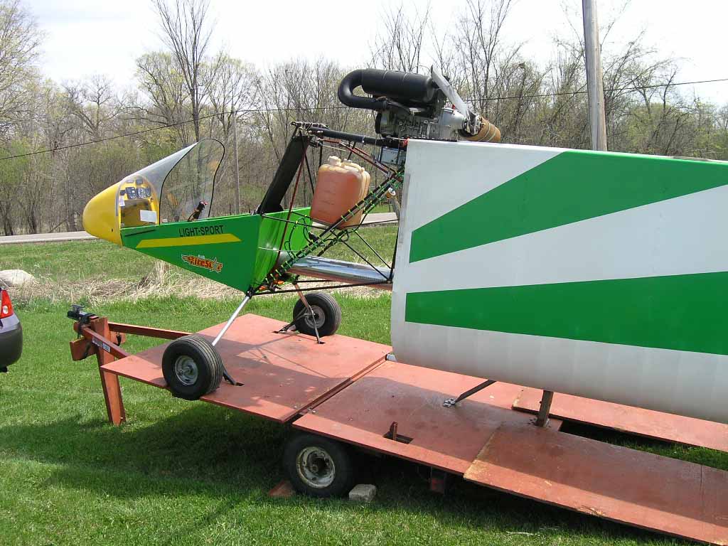

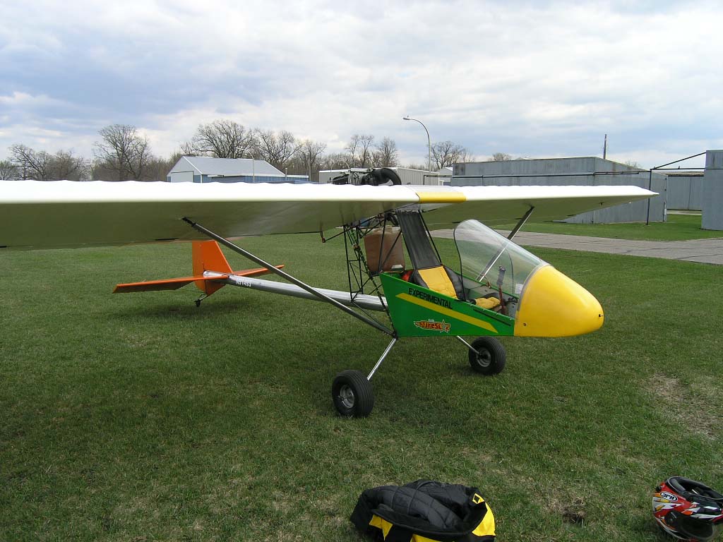

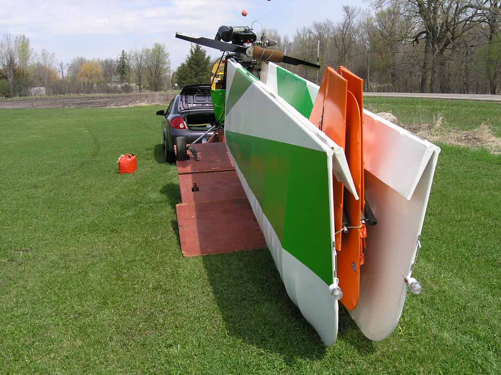

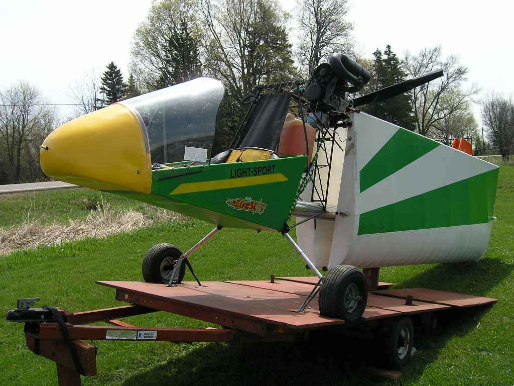

James, here are some pictures for you. I have the Original Firestar, which is very close to the Firefly you are anticipating except it's heavier. This trailer is only 8'x 5' with 3/4" plywood for the bed covered with deck stain.
It's been serving me for over 22 years since I unfold and fold every time I fly.

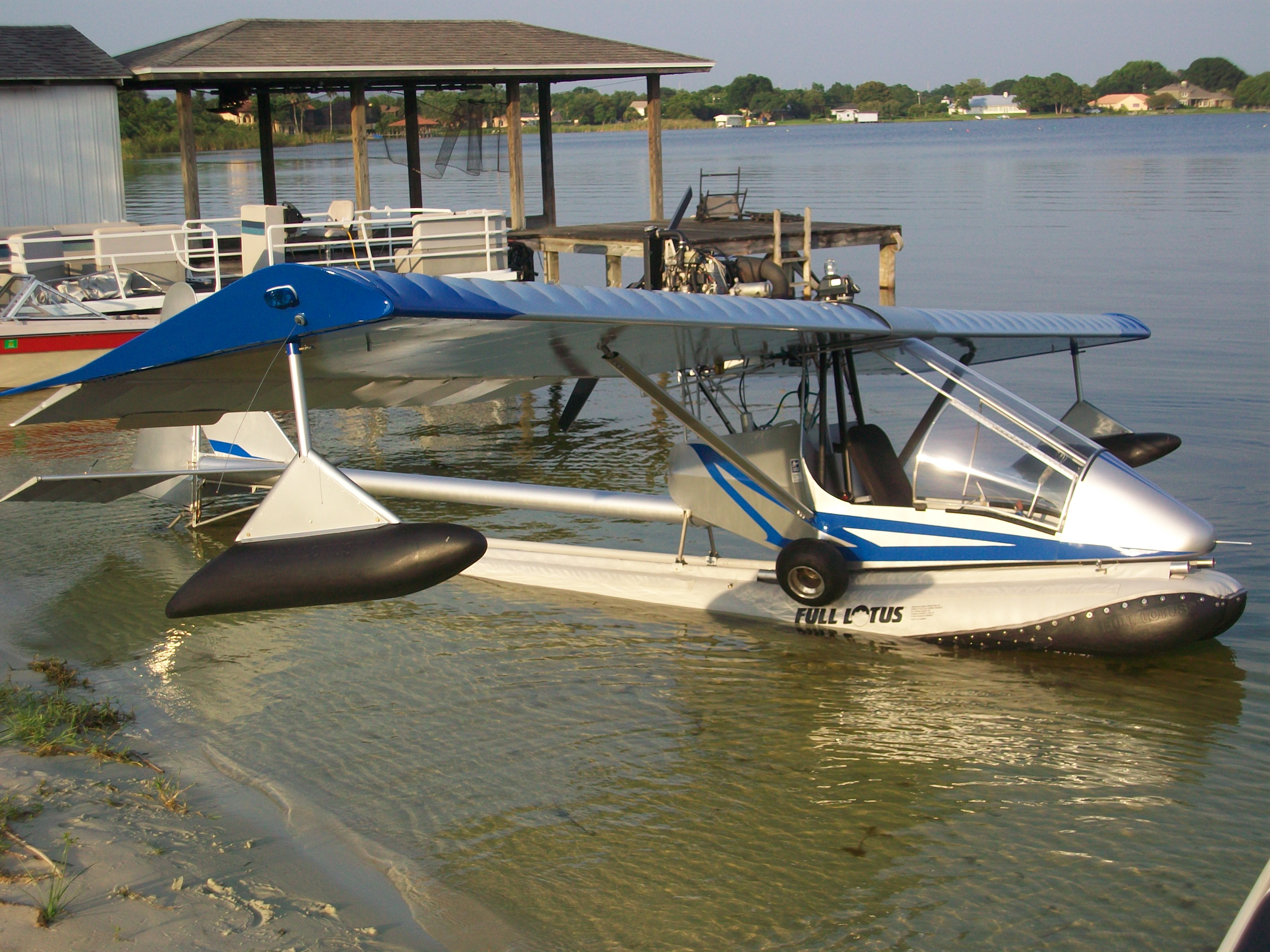

James C I have a FS for sale...it has clipped wings and cruises at 80mph...oh C by the way C its amphibious. heres a pic
Daniel

Thanks Ralph for the pic's, that gives me some idea of dimensions.
James. (nice pic's)

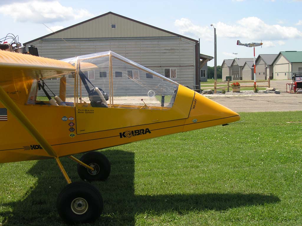

Bill, this is Winsted Minnesota. It's about 40 miles west of Minneapolis. Here are a couple more pictures of that airport.
