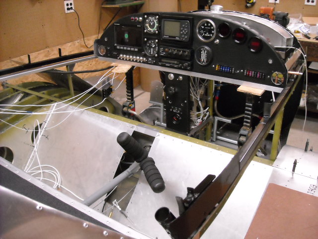

Ok Can I get some clarification and the search function did not come up with any responses worries me I may be in the wrong..
On the plans page 6-C-4 03/06 Part No 6C4-1 located on the fwd side of the canopy handle assembly shows it facing aft towards the handle.
When I measured the location this part inter-fears with the FWD hoop bracket 6-C3-9 . also the photo guide shows it reversed from the plans.
Which is correct? It works reversed to the plan. Was there a correction I missed? Also the plans do not say what type of rivets to use. Steel part to steal Support bracket.. AL rivets or SS rivets?
Chris..

PostPosted: Sat Jul 11, 2009 7:48 am    Post subject: canopy cable support 6C4-1 Reply with quote
Chris-
You really had me worried for a moment.
The only thing I can think of is you're measuring from the end of the
"Foot" of 6C4-1 rather than at the intersection of the bend. That's the only
way you could be off more than 2mm whether the fitting was faced forward or
aft.
I just measured my side rail and there's tons of room between where the
fitting is and where the front hoop is supposed to go. I used the print
dimensions and welded 6C4-1 to the square tubing. Picture attached, hope
this helps.
Bill

chris Sinfield
Joined: 28 Nov 2006
Posts: 270
Location: Sydney Australia
PostPosted: Sat Jul 11, 2009 7:34 pm    Post subject: Re: canopy cable support 6C4-1 Reply with quote
Bill
Can you measure from the bolt hole at the FWD end of the Side frame to the front hoop bracket 6C3-9 and also to the center of the vertical part of the 6C4-1 that you welded..
so 2 measurements.
Fwd hoop bracket is 510mm
next is the cable support at 6C4-1 at ???mm
Chris..

PostPosted: Sun Jul 12, 2009 10:31 am    Post subject: canopy cable support 6C4-1 Reply with quote
Chris-
Sorry it took a while to get back to you- I've been trying to do some
yard work between the local monsoons.
I get about 590mm to 6C4-1, depending on where you're measuring to. I
think I see what your concern is. The hoop bracket 6C3-9 has a foot that's
60mm long, and that will overlap the foot of 6C4-1 by about 20mm when placed
per the print. BUT, that doesn't interfere with placement of the frony hoop.
I haven't placed my hoops yet (I'm just closing up the cockpit and have
to polish at least the edges before mounting the canopy) but there's no
interference whatsover in the 510mm region for the front hoop. I'll jog the
foot of 6C3-9 to fit over the foot of 6C4-1. If what I'm seeing is what
you're worried about, I don't see any reason you can't reverse 6C4-1 to
eliminate the jog. I'm sure as hell not moving mine at this point!
If that's not what your problem is, both Larry Mac and I have noticed
differences in the print dimensions vs what you need for an HDS (Entire rail
is about 1/2" too long). I don't know what you're building and I haven't
seen any complaints posted by XL builders, so if you're building an XL this
should be a non-issue.
How's your panel positioned in relation to the firewall, and do you have
the new or old style motor mounts?
Bill
