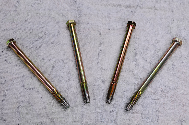

Yes, using hardware bolts works just fine. That's what I did on my RV-7A. I ground the ends of the bolts to give them a taper, greased them, then slid them in when the holes were lined up. They went in easy, held the wings in the right position to do the work needed, then with a little lift on the tips, were easy to drive out. You DO NOT want to use your close tolerance bolts and expect to ever get them out again.

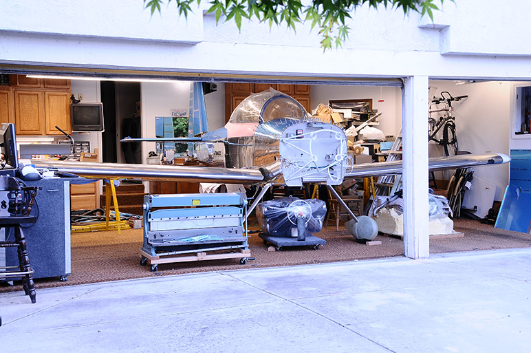

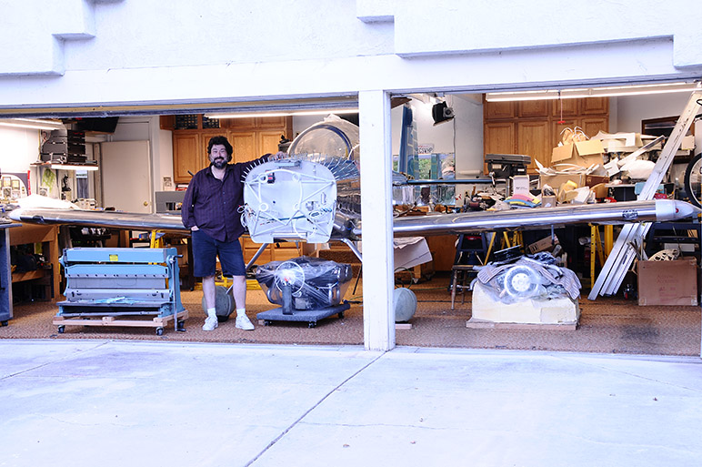

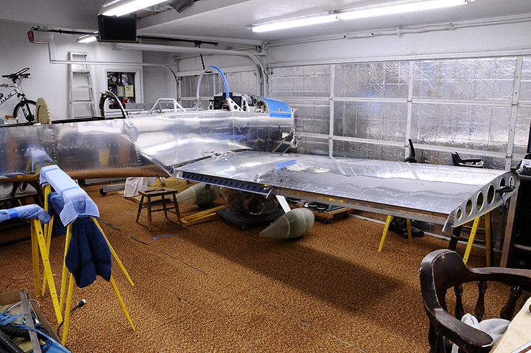

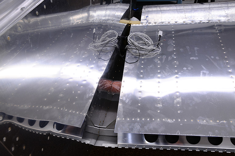

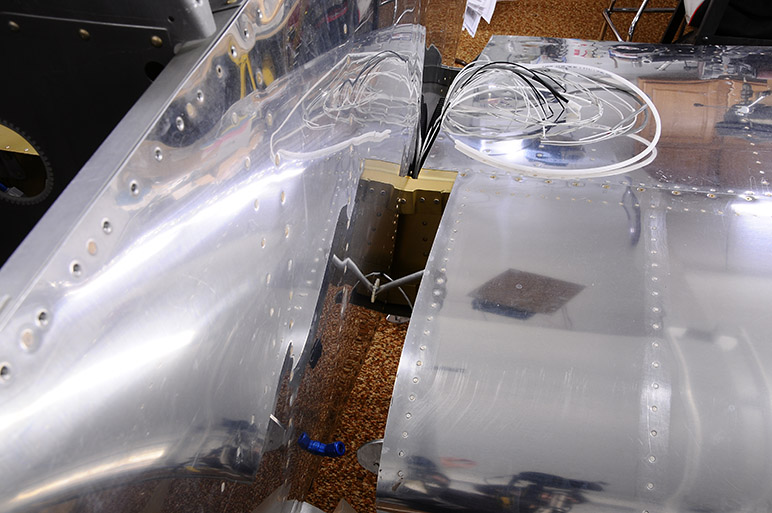

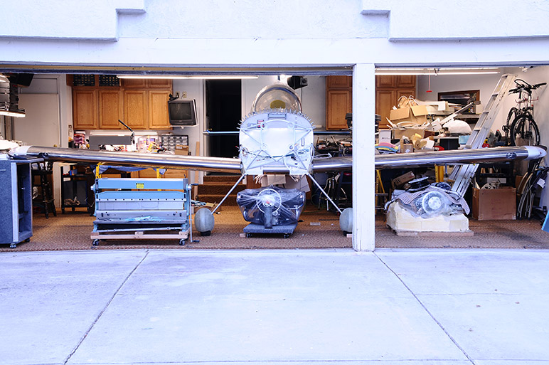

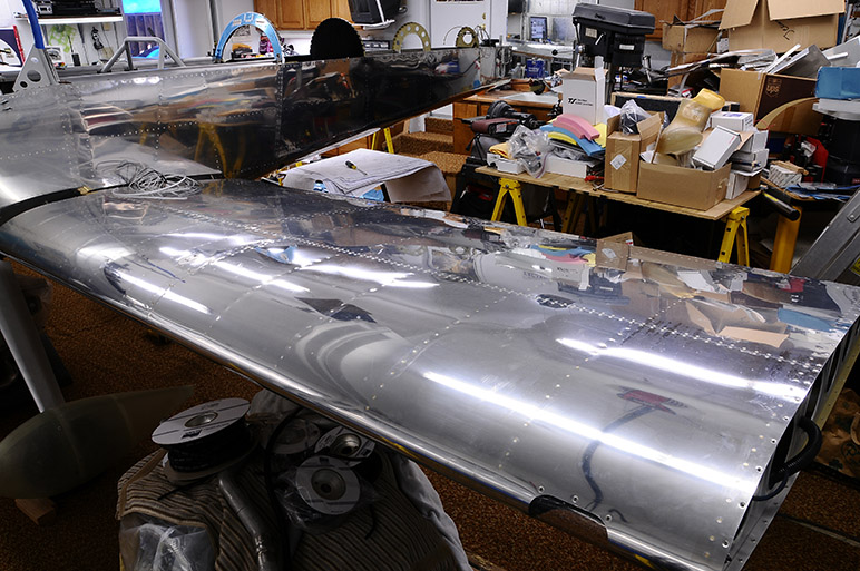

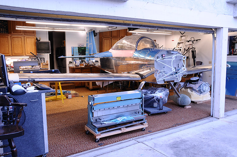

I want to thank everyone for the help on mounting the wings. The mounting went without a hitch today. The hardware store bolts just slipped right in with no problem. Highly recommend. I would say that they will be very useful in the initial alignment prior to inserting the close-tolerance bolts too.
Once the wings were on, I just had to put all the other stuff on the plane to get an idea of what it looked like. Awesome! I thought I'd share a couple of pictures... Yahoo!
Thanks again!

Nice job - it's beginning to look like a real airplane. I have to admire a
guy that has a choice of engines setting in his shop.Smile

I would recommend the hardware store bolt approach - the precision bolts
will be difficult to remove (impossible in the case of some of them on a
7A due to landing gear weldment). I think I used two per side of the
large variety - one top and one bottom. I don't have experience with the
8 install but just make sure you'll be able to get a punch on the back
end of the bolt to drive it back out - if access is better on one side
than the other I would orient the bolt to take advantage of this fact -
orientation doesn't matter until they go on for the last time....hope
this helps.
