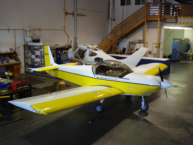

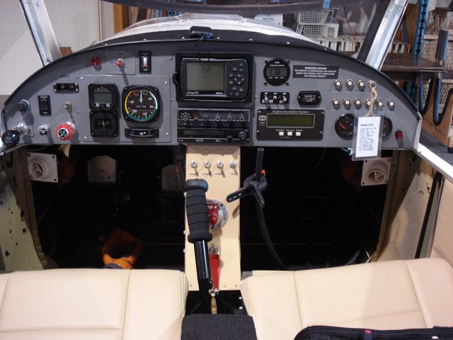

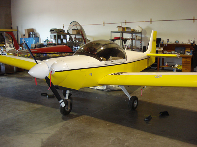

We JUST got Rich Vetterli's Zenvair 601XL off of the scales, and it came in at:
Left Main: 281.6
Right Main: 281.4
Nose Gear: 230.0
For a grand total of 793.0 pounds. His airplane is lightly equipped with minimal instrumentation for flight test, has a chopped down center stick, a single set of brakes, but has been painted and features soundproofing throughout. Warp Drive prop, no wheelpants (yet), just wingtip strobes without exterior nav lighting.
Three photos attached.
Phase 1, here he comes...!
Rick Lindstrom
First Light Aviation Group
Livermore, CA
www.flaglvk.com

PostPosted: Mon Jun 22, 2009 4:56 pm    Post subject: Weight and Balance on 601XL / Corvair Reply with quote
What a beautiful 601XL way to go!! My weights of the three wheels were almost equal. With the nose so light must be a lot more weight aft than mine.
