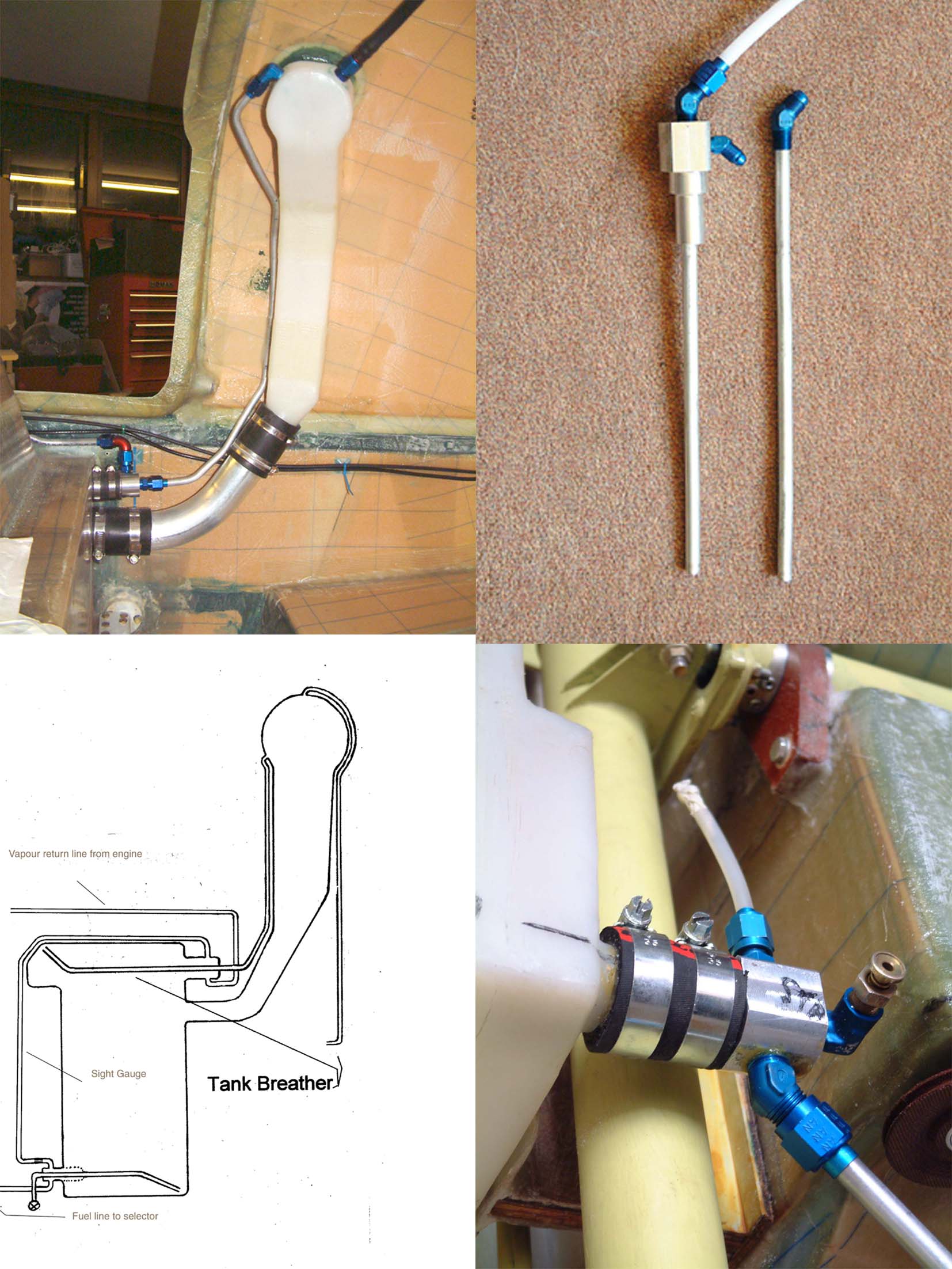

PostPosted: Fri Jun 19, 2009 9:40 am    Post subject: Re: tank size Reply with quote
BTW I observed a nasty issue when leaving the aircraft outside on a warm day, tank full (or close to).
Fuel spills off the vent, for what I presume being a significant quantity (taints the paint, and significant traces on the ground).
This drove me to the assumption that a significant empty space remains over the fuel, due to fuselage pitch on ground (3 wheels Europa's may not exert that). With warming, vapor tension increases and push fuel out into the vent.
I feel this ceiling space is wasted, on top of the spillage issue. Probably a tube extending front from the vent port into the tank could permit carrying more fuel, while avoiding the warming issue.
Has anyone already experienced and solved that?
Many thanks in advance,
Jean-Paul

PostPosted: Fri Jun 19, 2009 10:14 am    Post subject: tank size Reply with quote
You could use the same outlet, if you attach a small copper pipe to it,
extending to the upper front of the tank. I'm doing that, because the
tri-gear, while sitting on its trailer, is also resting with its tail
down, and filling the tank while driving to the airport would give me
the same problem.
Frans Veldman

pjeffers(at)talktalk.net
PostPosted: Sat Jun 20, 2009 1:08 am    Post subject: tank size Reply with quote
Hi,
I think many of us have seen this issue of fuel venting on warm to hot days
due to air/fuel vapour expansion.
The cure (and it works fine) is to route the vent pipe from the tank, to the
filler neck instead of the roof vent tube. Thus as fuel tries to vent
overboard, as in the past, it now vents back into the tank. Saves the mess
on the paintwork and also saves precious fuel!!!
You will however still need to vent the tank, so a further connection into
the filler neck now needs to be connected to the roof vent tube.
A further refinement used by some is to move the roof vent tube to the
bottom of the fuselage instead of the top. This later part of the mod
ensures that if for any reason the aircraft ends up inverted, fuel does not
run freely from the vent tube as it would if it remained on top of the
fuselage.
I think you will find this fix simple and very effective.
Pete Jeffers

houlihan(at)blueyonder.co
PostPosted: Sat Jun 20, 2009 8:55 am    Post subject: tank size Reply with quote
Hi
Would this solution work in the Classic original setup ? assuming you
run the vent pipe to the top of the filler pipe in the alloy receptacle
Tim Houlihan.

grahamsingleton(at)btinte
PostPosted: Sat Jun 20, 2009 9:13 am    Post subject: tank size Reply with quote
Tim
should work fine but not as easy to fit a stub into the hose. Not sure
how I'd do it
Graham
Tim
On second thoughts, I'd replace the big hose in the Classic with an
aluminium tube, help to get rid of the fuel smell too!
Graham
PostPosted: Sat Jun 20, 2009 1:50 pm    Post subject: tank size Reply with quote
Hi Graham
That sounds like a good idea.
What wall thickness do you think would be required to allow the fuel
hose to be clamped to the alloy tube at the elbow?
Tim
