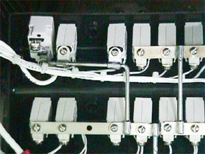

Breakers that assuage concerns for aircraft designers
have terminal bosses compatible with bus bars that
tie multiple devices together. Like . . .
[img]cid:.0[/img]
The R11 has fast-on tabs that do not lend themselves

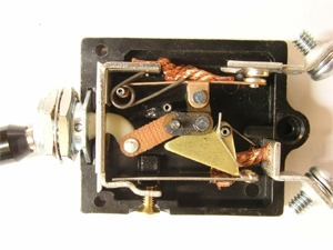

to direct connection to bus bars.
[img]cid:.0[/img]
As I said, my
experience has been good, I'm confident in the reliability
of the device, I like the simplified wiring and also like
the reduced panel usage.
As to absolute reliability, the numbers are
inversely proportional to parts count and without
a doubt, the breaker/switch is more complex than
the plain switch. Reliability is inarguable.
Bonanza and Baron owners are presently saddled
with some parts-count issues in the utilization
of this breaker/switch . . .
[img]cid:.1[/img]
It's a sure bet that they're wishing we'd not
strayed from the simple breaker-panel, switch-
panel architecture common to most other airplanes.
This albatross involves about 80,000 fielded
breaker/switches.
