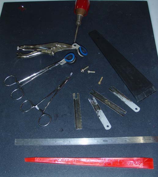

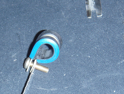

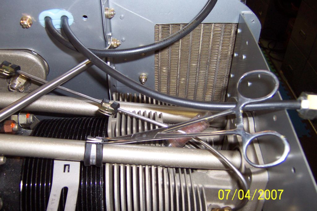

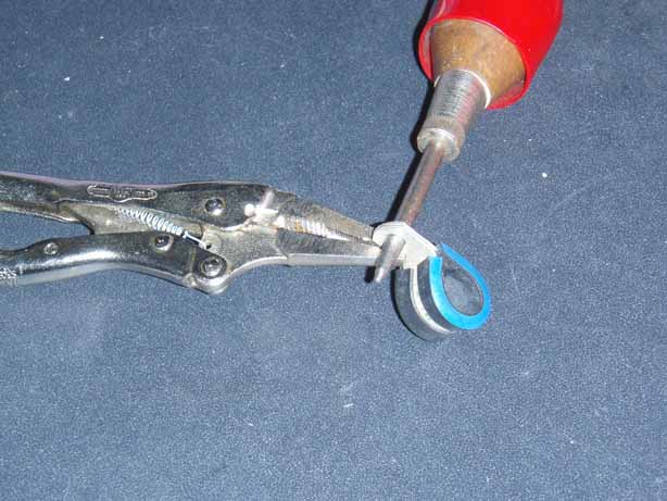

AV8ORJWC
Joined: 13 Jul 2006
Posts: 1149
PostPosted: Sun Mar 08, 2009 9:57 am    Post subject: Adel Pliers Reply with quote
I will capture several pictures from work tonight and edit them down for
the bandwidth impaired. An Awl (from Harbor Freight), A discarded
locking medical forceps or two (they sell new ones at Harbor Freight), a
broken hacksaw blade 3" long(I have a few). The Pencil Die Grinder was
already talked about to fab the blade mod. The finished product will do
6-32, 8-32 or 10-32s in a second. For the more technical types that
would be MS21919 clamp installations.
Double or Quad stacked Adel's that are filled to capacity are lots of
fun (Like tying your shoes with gloves on). For the $86 bucks that will
buy a lot of Tall Neck Lone Stars, Coors, Sam Adams, Becks or Big Gulps.
We ran into a problem working inverted inside fuel cells and under floor
boards (blind) with just the forceps. An ole timer got out his "Poor
Boy" tool. Pictures will answer the 1,000 words that no one wants from
me.
That said, some of us are still suckers for more tools. Will answer
questions to the pictures "Offline".
John - #40600

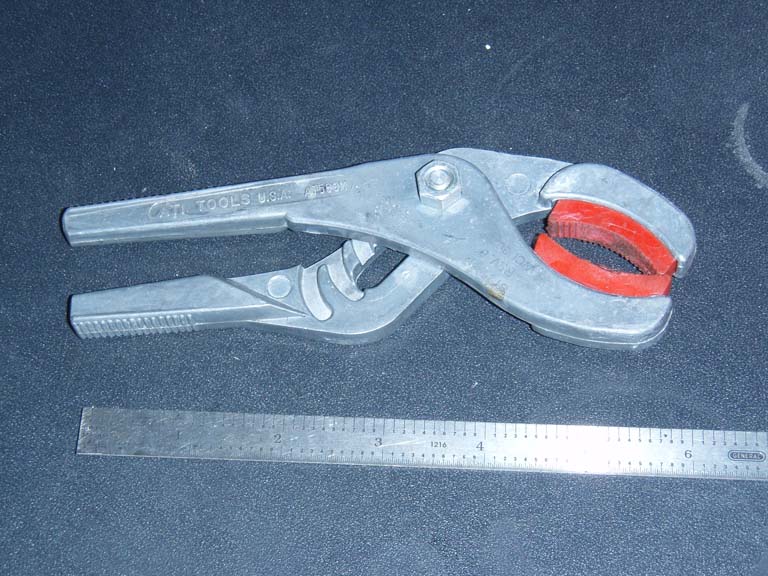

PostPosted: Wed Mar 11, 2009 12:23 pm    Post subject: Adel Pliers Reply with quote
Here are the shots I promised. One is a range of cheapo tools, another is a modified Canon Plug pliers, another is the use of the ole busted hacksaw blade. They should be self explanatory. They are designed to work in Tight spaces to which the really cool $86 pair will not fit. The blade is grooved with a 3" Harbor Freight cutoff wheel to accept 6,8 or 10-32 Adel Screws and MS attachment nuts. Your fingertips will love you.

PostPosted: Wed Mar 11, 2009 1:05 pm    Post subject: Adel Pliers Reply with quote
I actually bought a set of Adel Pliers at OSH a couple years ago and after a couple times using them I went back to the fly market/Harbor Freight hemostats and needle nose vise grips as shown in John’s pix.

PostPosted: Wed Mar 11, 2009 7:01 pm    Post subject: Adel Pliers Reply with quote
Bob,
Where we you when I started down this life of building 4 airplanes ago?! Great pictures, nothing beats a simple/cheap approach. I’ll certainly use these a lot on my next project.
