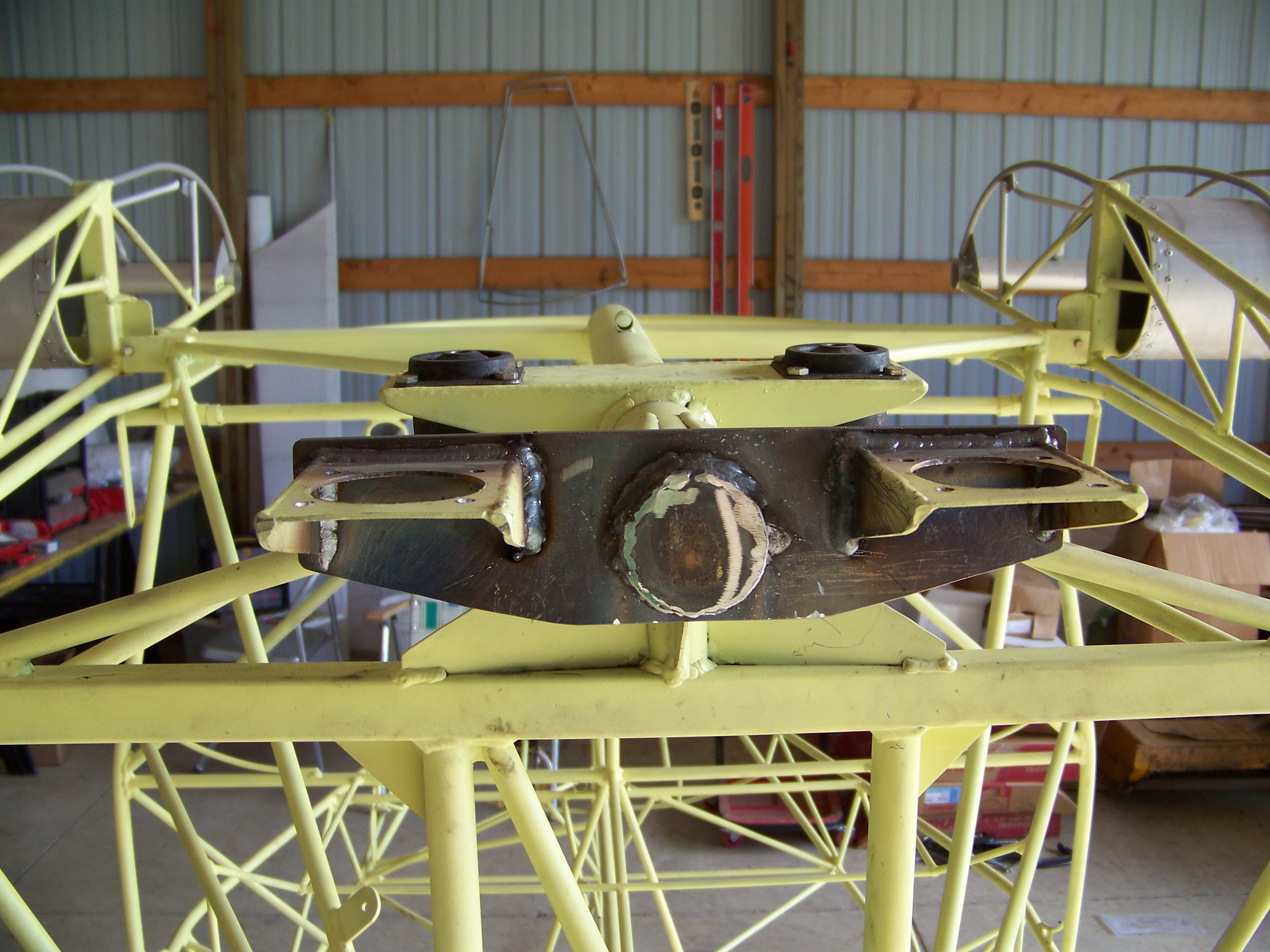

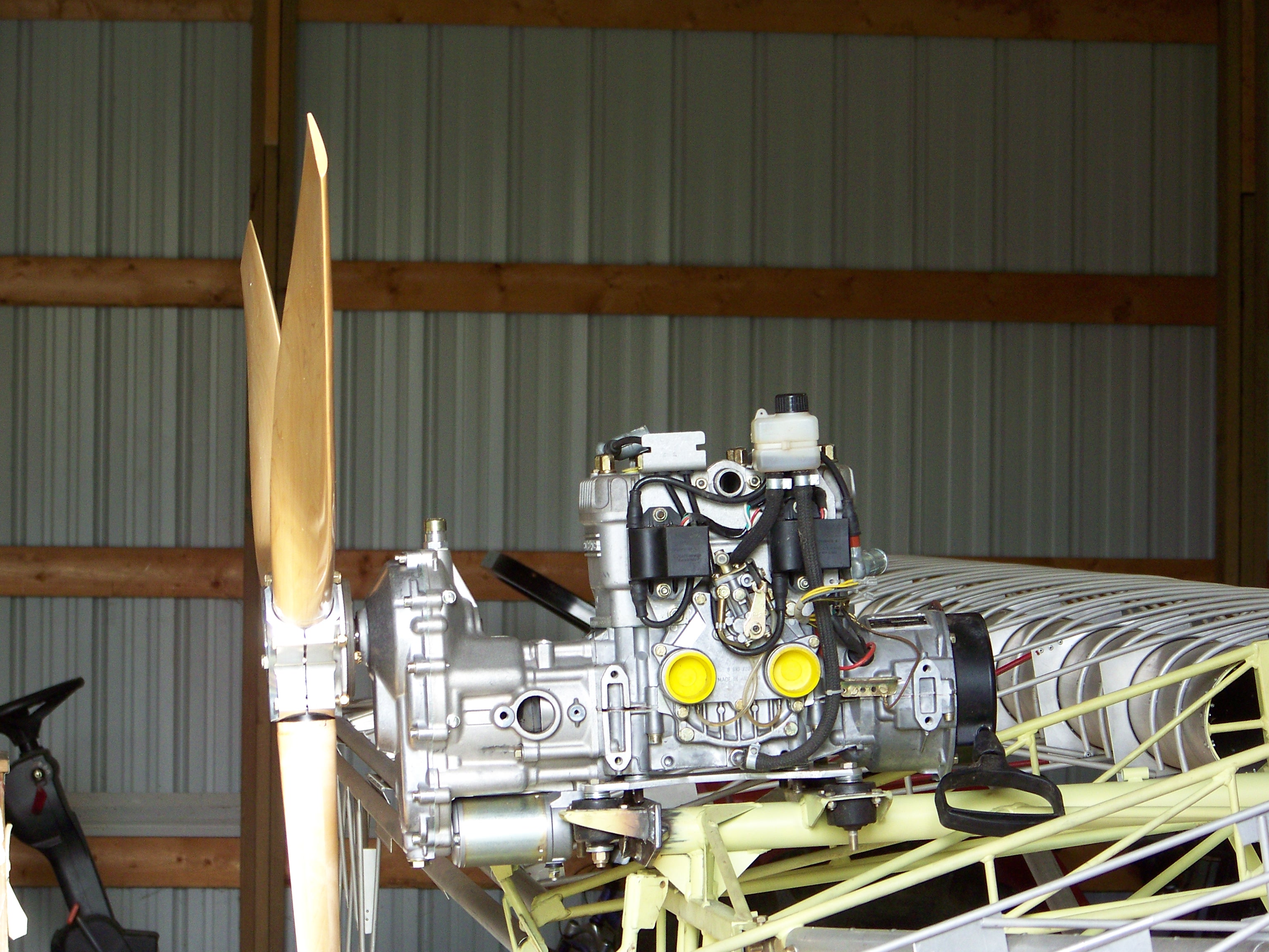

Mark,I'm building a mark 111c at this time.My motor is a 582 that I put a e-box on.Rather then raising the motor much I changed the rear mount.I removed rear mount,took off app. 2 inches of the root tube.Put a 1/4 plate across and turned the mounts rearward so as the starter could sit between the mounts with plenty of clearance.The motor is sitting exactly the same as original.Not flying yet.Pictures attached
Gary Jindra
