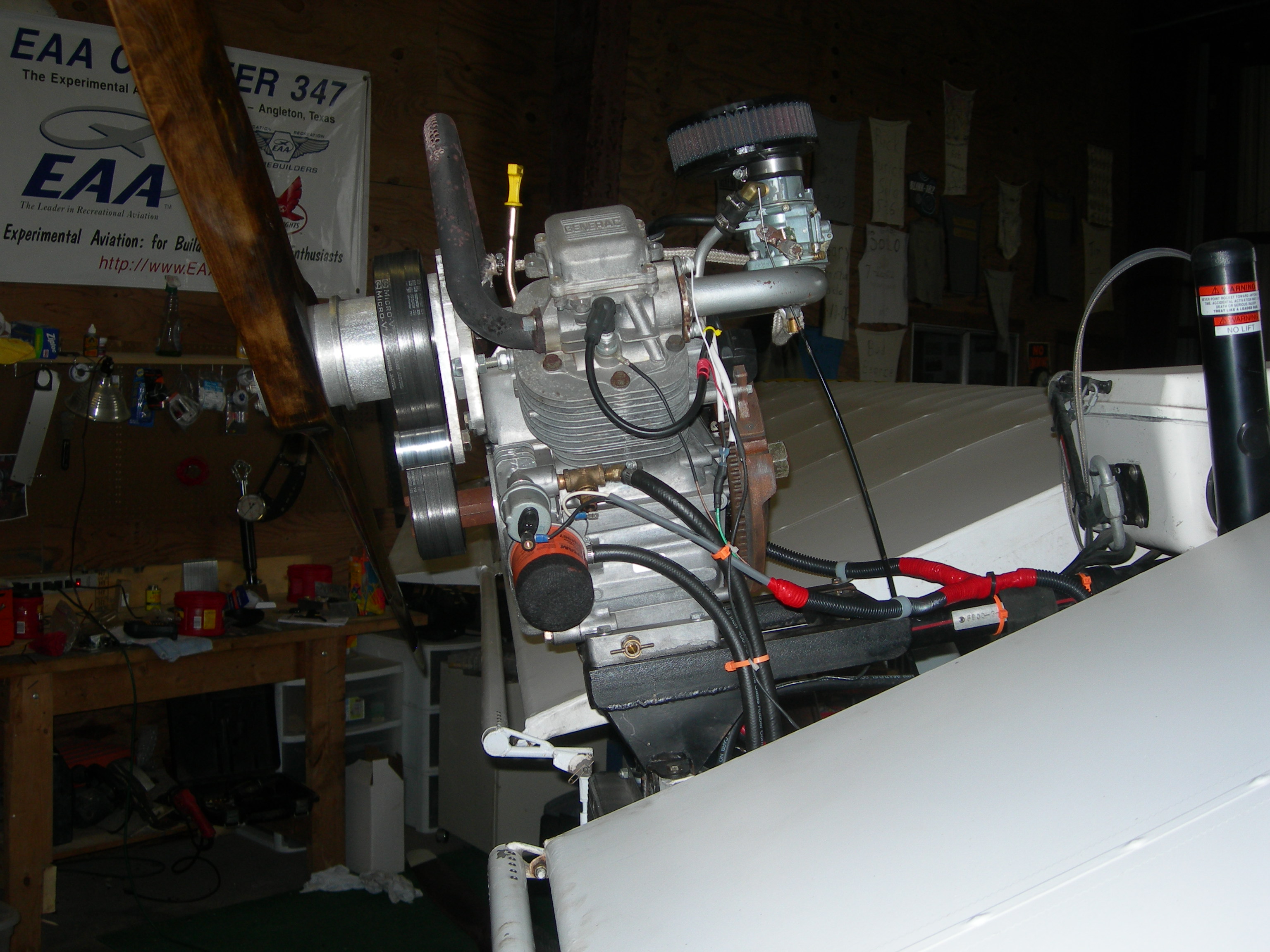

I pulled the air-cowling off the engine about 6 weeks ago, (see photo) and that got rid of the blower fan HP draw which gave me about an 80 RPM increase in my RPM's. The cyl temps stayed the same, except for about a 20 deg increase when idling or taxiing. Prior to that, prop #1, the 78X41, would allow 3500 RPM max at WOT, & afterwords it would hit 3580 -3600 so I gained a bit of power there, plus cut some weight.
