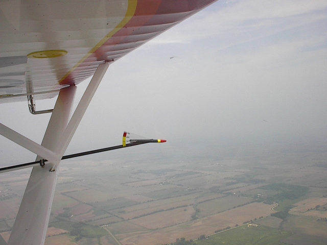

I have my handy dandy, poor mans bacon saver. Made from a carbon
fiber tube with a lexan background and marked at 10,20,30 degrees
about mid red is where it stalls. Power on, power off, the wing stalls
at the same angle. The little birdie on the boom has a aluminum fin.
It's fun to fly with, and taught me a lot about the plane.
I don't fly with it any more, as I discovered that aircraft feel with my
plane is just as usefull. The plane is very friendly flying, and it gives plently
of control feel feedback.
However, it cost me $0, and one hour time to make, and the parts were
stuff from the scrap box. It works very well and I can see it in my peripheral
vision very easily.
Jeff
 Filesize:  186.23 KB
 Viewed:  29196 Time(s)

PostPosted: Fri Apr 24, 2009 9:41 am    Post subject: Re: Lift Reserve Reply with quote
I'll sell you the one in the picture above for half that, only $225 PLUS
I'll cover the shipping!
It's super sensitive, and requires no maintenance. It's dead accurate,
and works in any weather conditions. PLUS it looks cool.
Jeff

PostPosted: Fri Apr 24, 2009 10:39 am    Post subject: Re: Lift Reserve Reply with quote
I have to say, I think these systems are grossly overrated. They all do the
same thing. The super simple one I made works just as well as even the
most sophisticated systems. It might not look like much, but you can see it
and it is absolutely accurate.
I'm not going to say that somebody shouldn't spend the money if they
want to, but the one I built is plenty easy to see all the way down to short
final, at which point I'm not worried about it anyway. The big advantage
was it was free to build.
I used to work on Grumman E-2C Hawkeye's in the Navy, and they
have a very sophisticated system tied into the planes air data computer,
however in the end even it did pretty much exactly what the boom on
the wing system does.
I've flown sailplanes, and in them a simple piece of yarn on the windscreen makes a great slip indicator. So you really don't need
something all to fancy.
Jeff
