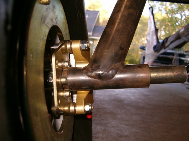

Axle extended a bit. Do you think this would be a problem.

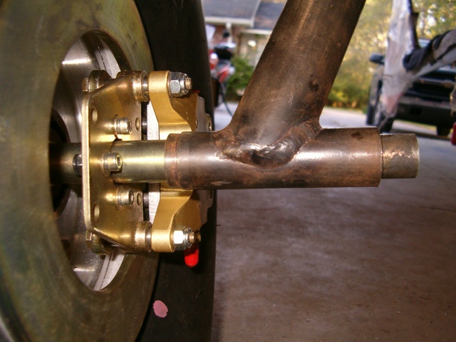

Axle mounted flush against sleeve.

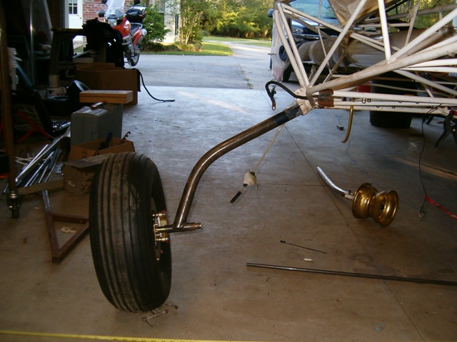

Sit a bit higher with new gear and wheels. Notice the original bent gear in the background.

| Before I drill the holes for the axles I wanted to see if I was
close to the right dimension for the distance from the outside to
outside of the wheel. Kinda like the look better.
| John Bickham
Looks great to me. I like a lot of positive camber.
As far as track is concerned??? I don't think it makes a lot of
difference. My gear is probably a foot wider than standark MKIIIc.
Helps me keep the wings level when I ground loop. Wink
Recommend using two 1/4" bolts in each axle socket. When I put on my
upgraded brakes, I was using the stand two 3/16" bolts. First time I
taxied down to the end of the strip, used the brake to pivot, I wrung
off the two bolts. That is when I decided to upgrade to 1/4.
Gonna be a good looking, good flying MKIIIc. Already been initiated,
so don't have to do that anymore.
