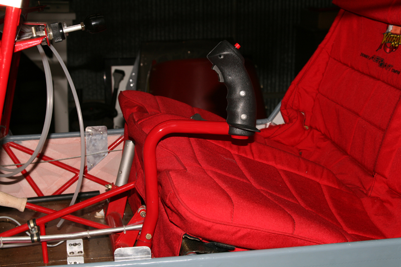

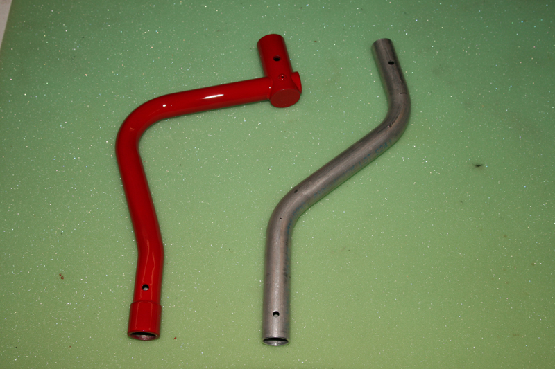

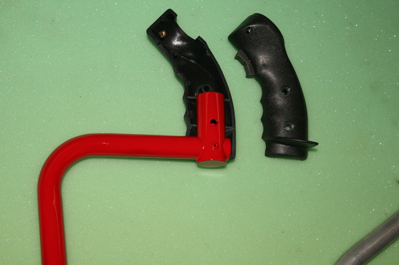

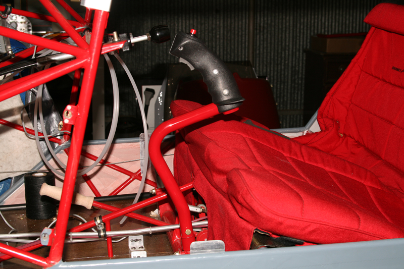

After being inspired by a friends Schweitzer (helicopter) control stick I decided to design and fabricate new control sticks that would keep the grip in the same location as the stock grip but have absolutely no contact with the seat in aft positions. After finally talking a local tube bending machine shop into taking a crack at it (without a minimum order of a 100 sticks) here's what I came up with. Our new grips were a few inches taller than the generic stock grips so I was able to modify them to have the stick enter through the front instead of the bottom thus lowering the grip an inch without lowering the stick. Shot it with an etching primer and an auto urethane to match the plane powder-coat.

Chris, Just some ideas, maybe I'm all wet. Without the stick contacting the seat, strong arm force will be put on the elevator control tubes and rod ends at full aft elevator when the rod end at the aft end of the control tube contacts the vertical fin tail post. You will have some pretty significant leverage advantage on those parts with the stick Might want to caution anyone else that might fly the plane to stop pulling when the stop is felt. It is a very nice looking modification.
Hey Tom, You have a good point and I should have described that portion a little better. About 3" from the bottom of the stick at the point where it bends forward, it actually stops on the seat bar at the same time that the elevator stop is reached. what I meant by not touching the seat was that the stick is not buried in the cushion when aft. the stick still stops on the front seat bar.
