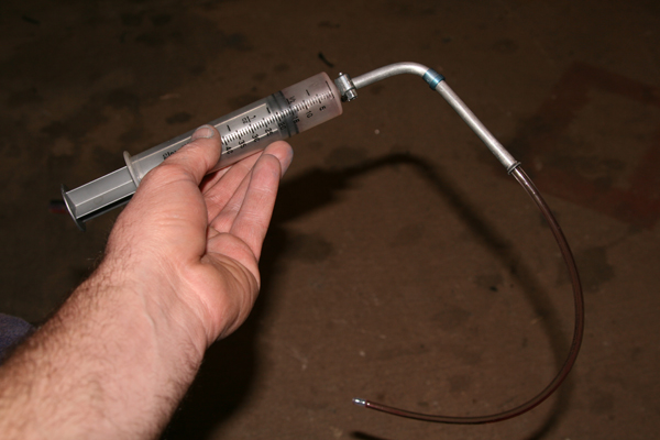

The oil can is a good idea. Heres what I did, seemed to work pretty good and I already had the materials laying around. I had a big syringe that I had gotten from a farmers co-op or southern agriculture. hooked some tubing to it and done. I think All it took was one syringe full. heres a pic, doubt I could sell (it's not pretty) it but it works well.
 Filesize:  162.74 KB
 Viewed:  24850 Time(s)

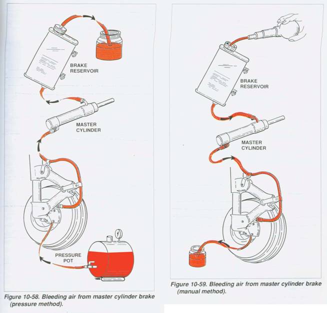

I, like most of us have been following this thread with a little interest to see what direction it will take. While it is true that you can do basically whatever you want with an amateur built plane there are still recognized procedures for doing specific tasks.
This is the one described in the Jeppsen A&P Technician Airframe Textbook. After all the years they have been training A&Ps I guess they have some idea what they are talking about.. Please pardon any typos you find.
PP10-29, 10-30
D. Brake inspection and service.
1. On the Aircraft. Sub b. Check for air in the system.
Spongy brake action is nearly always an indication of air in the system ( hydraulic system), and if any air is found it must be removed by bleeding before proper braking action is restored.
There are two general methods of bleeding brakes, and while basic procedures for each will be discussed, the airframe manufacturers service information must be followed in detail.
Note: As manufacturers of our planes we set those standards.
1. Master Cylinder Brakes
When the brake master cylinder is fully released, there is a direct passage from the brake cylinder through the compensator port to the reservoir. This prevents any pressure build up from heat causing the brakes to drag. To bleed this type of brake, remove the screw from the bleeder valve and connect the brake bleeding pressure pot ( Pump with brake fluid in it.) to the brake with a flexible hose. Before tightening the line on the bleeder hose be sure to purge all of the air from it.
CAUTION: Be sure the pressure pot is filled with the proper type of hydraulic fluid, as improper fluid can cause serious damage to the system. For most of us that will be 5606.
Attach a flexible hose to the brake reservoir vent and place the end of the hose in a clean container, As shown in Fig. 10-58. Open the bleeder valve with pressure applied from the pot to force fluid up through the brake, the master cylinder and the reservoir into the container. Allow the flow to continue until there are no more bubbles. Close the bleeder valve and the valve on the bleeder pot and remove the line from the brake. Replace the bleeder screw and remove the line form the reservoir. Check to be sure there is the proper amount of fluid in the reservoir.
This type of brake may also be bled by forcing trapped air out of the system at the wheel cylinder, See fig 10-59. Slip one end of a section of flexible tubing over the bleeder valve on the brake and immerse the other end of the tubing in a container of clean hydraulic fluid. Check to be sure the reservoir is full of fluid, and depress the master cylinder. Hold the piston down and crack the bleeder valve on the wheel (a two man job to be sure) allow the piston in the master cylinder to go all the way down, and then close the bleeder valve before you release the master cylinder. Continue this procedure, being sure to keep the reservoir full until fluid flows from the brake with no bubbles.
So it appears both methods are acceptable. I notice in both these diagrams the bleeder appears to be below the brake line on the slave cylinders.

patreilly43(at)hotmail.co
PostPosted: Sun Apr 19, 2009 9:53 am    Post subject: Brake Bleeder Reply with quote
Dick C Alot of us have one piece reservoir master cylinders on the pedal. I bought a remote reservoir ( fluid visable ) C but can't use it with the one piece master cylinders with reservoirs. Did you have a remote reservoir that you couldn't see the fluid in originally? Also C you reported Lowell's brush gear was 4# lighter than the original stock. I wondered how that could be at the time. I see Lowell reports his gear is  9 pounds heavier than stock C which looking at the gear would make more sense. Did I misread your report on lowell's bush gear?
Pat Reilly
