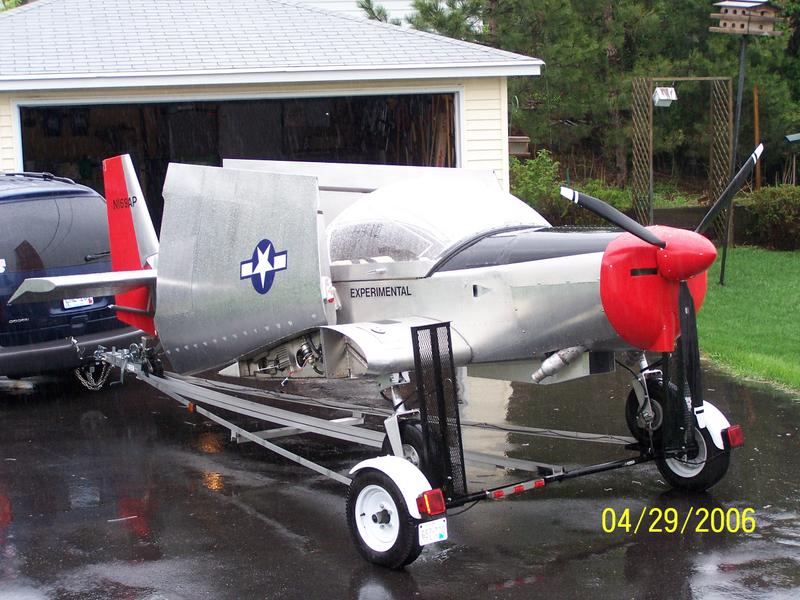

Hi Alan,
The attached image was one I saved back because it was a well done
construct for the tail dragger 601. For a tri gear, this would be a bit
different, but doable.

It's the old weight and balance coming in to play here and having the wheels aft would be the why to go but the track would be to wide [max width 8' or 2.4m above this would need Police escorts with flashing lights,route feasibility study and permits].With the boat trailer there is properly 100 + kg forward of the axle[and it's 4m long with the hitch,winch and jockey wheel support right at the end of the lever arm] so I'm hoping this will counter act the a/c weight.I'm still trying to figure out the best way to support the main wheels and how to make the ramps as I do like the way it's done in the above pics Cheers

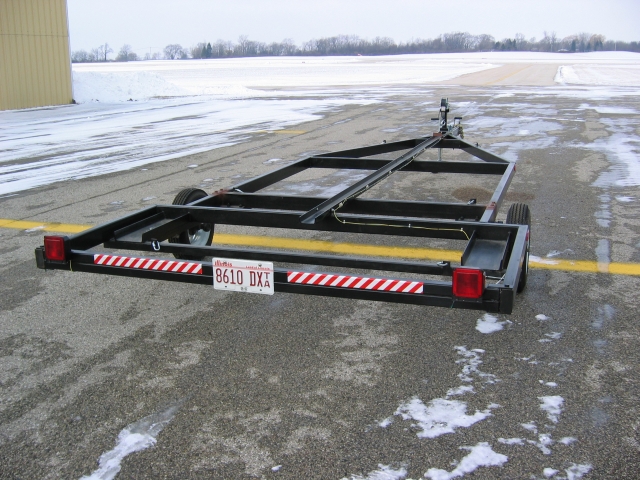

Here's a Kitfox trailer I built. The back bar on the trailer swings open,
and act as a bumper so to speak, for curious tailgaters. Not shown
are the loading ramps.

The section rear of the axle is what I'm working out now and the above pic looks like it would work for me as well.With the CofC of the 601xl just fwd of the main wheels and by putting them as close to the trailer wheels as possible, I should be in the ball park with the W/B. Thanks Everyone for your input

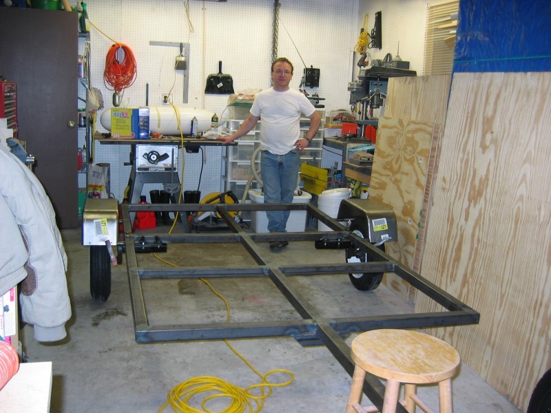

Here's another small trailer I made, it became a micro camper with a
removable shell that could be used as a utility/motorcycle trailer:
