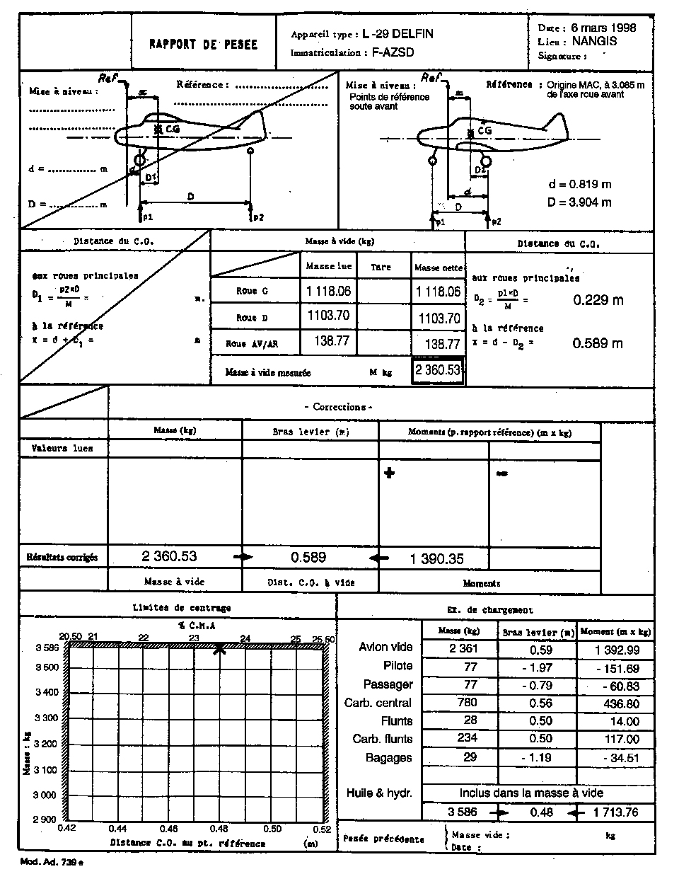

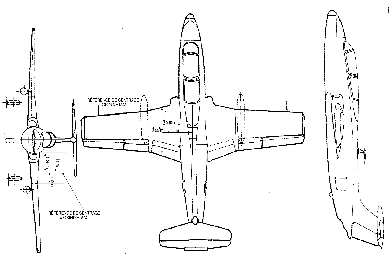

Afternoon Everyone:
We are at a point on our restoration efforts of an L-29 to weight it and calculate the CG.
I have a major problem, I can not find in any of my manuals a CG chart or datum.
Any advise or info would be very appreciated.

You have something in L29 Maintenance Handbook, weighting procedures ([url=http://www.l-29.org/6.htm)]http://www.l-29.org/6.htm)[/url]I have also this documents if it can help
Jean de Roubin

Dear Mr. Jean de Roubin
Thank you very much for the diagram, my French is very lacking but with the Internet I can translate what I need very easily and solve the mystery.
I really appreciate you taking the time to post this information for me.

All radios and nav (radiocompass) were removed. Modern ones instead. As most is in the middle, it does not affect much center of gravity. As I have an air compressor in the nose right, place of IFF, my plane was weighted and is well balanced without any weight in the nose or in the the tail.
My empty weight is 5193 lbs with 28,85 % MAC.
Center of gravity should be beetween 20,5% and 25,5% MAC in flight (flight manual 5.Cool
It flies like this from many years and goes out of stalls and spins without any problems.
Jean de Roubin
