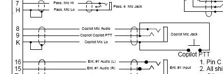

Anyway, 12 hrs into the pursuit, the problem turns out that the mike key and audio hi wires were connected to the wrong jack pins - on each mike jack (pilot, co-pilot, aux).
On a microphone plug the tip is the mike key connection - NOT the center band like I thought. So obvious and yet so hidden... I'll bet more than one person has been bit by this misunderstanding! How come THAT wasn't in the FAQ's - eh?

If you had queried the AeroElectric Connection
website search feature on "microphone" . . . one of the
hits you would have received . . .
http://www.aeroelectric.com/articles/micjack/micjack.html
. . . speaks to this issue.

Yep - that's the article! The light bulb went on at that moment!
Very clear essay on the subject Smile Thank You!

PostPosted: Thu Mar 19, 2009 3:39 am    Post subject: The Obvious Reply with quote
At 07:33 PM 3/18/2009, you wrote:
Something else that may be a gotcha on this system is that they want the jack isolated from aircraft ground and that the shield grounds are back at the ps1000 box, not at the jacks. I have a pdf schematic of the wiring if any are interested, email off list. Thanks.
Yeah, keeping the microphone and headset jacks ISOLATED
from the airframe is an important noise mitigation
technique. B&C has the washer sets.
I also peeked at the PS Engineering schematics I have
on the hard-drive. Their depiction of microphone wiring
is typical of the industry and echoed in all of my
drawings as well. If you check the locations of the
signal contacts on the mic jack symbol, PTT is furthest
away form the panel bushing, microphone audio is further
in. It's a subtle thing but imporant.

Dave,
I also had the same problem. My wiring is usually very good as I
check everything twice and follow the schematics faithfully. I have just
finished my second build. I have had no problems on my side. Then I
needed to have a passenger (finished my phase 1) and I could not talk to
him. I checked my wiring and thought that the PS1000II was the problem.
It was out of warranty and they (PS Eng) said that it would cost a bit to
fix the unit if it was bad. They said that the PS1000II is bullet proof
and they did not think the problem was in their unit. I had them send a
new unit just in case that was the problem. I was trying to get my
bi-annual flight check out of the way. When I swapped the intercom out,
the problem remained. I went back and did a very close check on the
wiring at the female jack. I had reversed two of the wires. I reversed
them to make the wiring correct. Volia --- everything worked fine. I
returned the unit to them and asked if there was a charge for the use. I
have not received a bill. This is my second PS1000II I have purchased
from them and if I build another plane I will use them again. I also
recommend the unit as it will let you set the squelch and volume
independantly. A great company. JMHO

Richard Girard wrote:
For many years I worked in QA for office products and the aircraft
industry. It never ceased to amaze me how companies will become so
entrenched in their way of doing things that they fail to take a step
back and analyze the costs of problems like these in terms of service
and ill will. Taken in that light I'd bet dollars to donuts they'd
find it was actually cheaper to bundle the harness with the intercom
even without a price increase over the cost of the intercom alone.
It wouldn't even take a full harness. Supply a little box and give
instructions to connect each of the mic/earphone combinations to the
little box. One wire from the box clips to airframe ground. There is a
connector for a 9V battery. On the front is some green LEDs and some
red LEDs. If you have the jack wiring correct, everything lights up
green. One of the wires hitting ground will give you a red light. A
single sheet of paper will tell you what is wrong with each jack.
The OBAM guys just runs through each of his jacks, and then connects
them to the intercom as each is confirmed. Bonus points if the little
box has a buzzer to confirm sound gets through to the headset. If they
don't want to give the things away, take a deposit, send one with each
unit, and refund the deposit when you get it back.
It's true that selling a highly technical device to the uninitiated is
difficult, but if you're not willing to confront the difficulty, don't
do it. Wiring the intercom is complicated, but it is not complex. You
have lots of wires, but each set basically does the same thing. It is
just a matter of confirming each piece individually, and then doing the
same operation several times. Smart companies take the time to look at
the problems their customers are having, and then takes steps to address
them.
