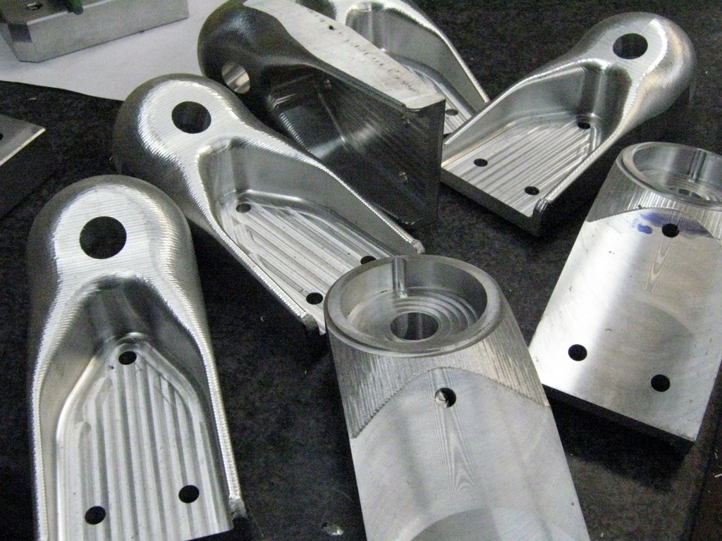

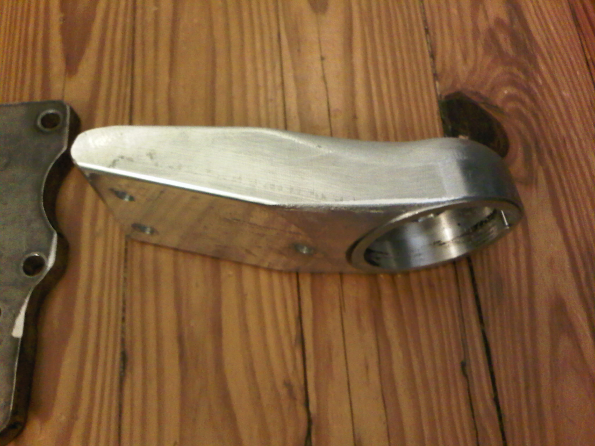

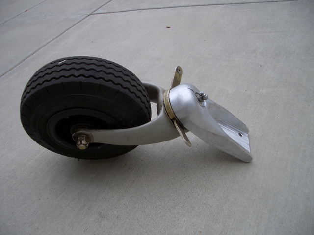

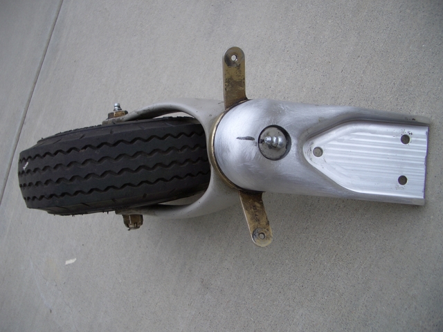

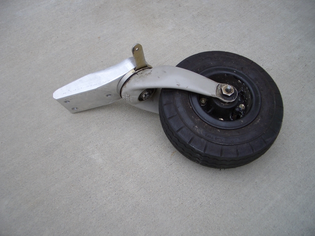

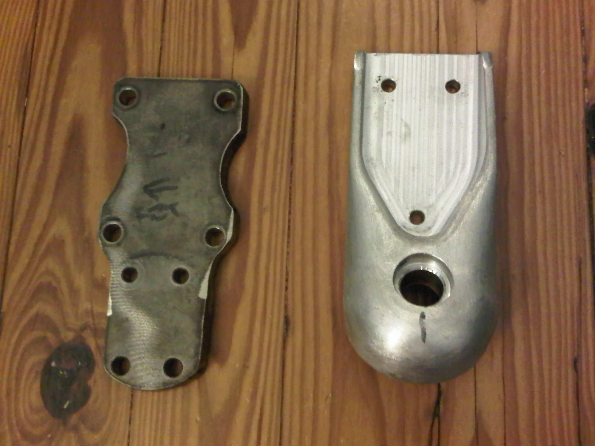

PostPosted: Sun Mar 15, 2009 7:48 am    Post subject: Scott Taliwheel for Yak 55M Reply with quote
Here are some pics of the assembly I had made. It bolts up underneath
the spring just like the original, using the the original holes,
etc... I had a bunch made. I'm not sure if the guy has any left
over. I could check if you're interested. I don't recall the cost
exactly, but I know they weren't cheap.

PostPosted: Sun Mar 15, 2009 8:19 pm    Post subject: Scott Taliwheel for Yak 55M Reply with quote
I'll find out tomorrow what/if there are any more available. The
angle is set so that it is correct if you have gear extenders
installed (I did with Clevelands). If you don't have the extenders,
it's possible I could sell you the one that I have here. It has the
original angle (copied from the original tailwheel). I don't have the
model we did. It was done at the machinists facility. If he doesn't
have any more, I can create a new model from the one I have here.
These planes are a little tough for parts. I had to have aileron
bushings made as well. The availability wasn't good enough. If you
need some of those... I have extra sets. The easiest way to do a
quick check is to just to try and move your aileron at the tip
vertically. If you feel any play at all, chances are that they need
replacing.
Wes

I found the one adapter I have here at home. It was packed away. I
have attached a pic of it. In the picture is a gear extender as well,
so you can get an idea of what they look like. This particular Scott
adapter is for a plane without the gear extenders. It will work on
one with them, it's just not perfect.
Wes

PostPosted: Fri Apr 03, 2009 6:02 pm    Post subject: Scott Taliwheel for Yak 55M Reply with quote
Ok. The guy got back to me tonight. He sent me a pic of the adapters
he has left (7 of them) and is looking for the digital file. I think
they are complete except for a counter-bore hole and a final
sanding/finishing. I'm trying to work a deal with him on all 7. If
it works out, they should be around $150ea with the final
sanding/finishing to be done by the buyer. They're made of 7075
Aluminum. They bolt up to the existing tailwheel spring on Yak 55 and
55M's with no modifications. If anyone is interested, please let me
know so, I can give him the go-ahead or not.
