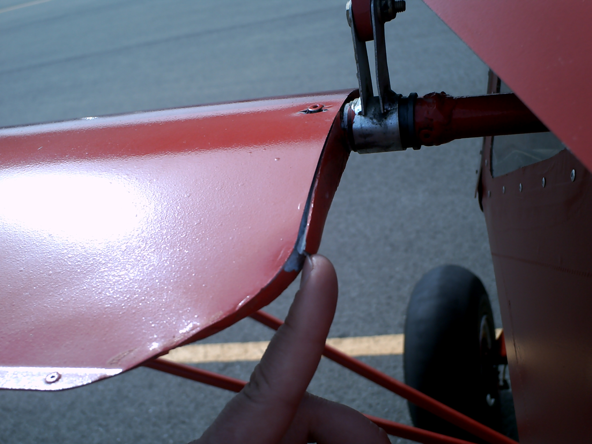

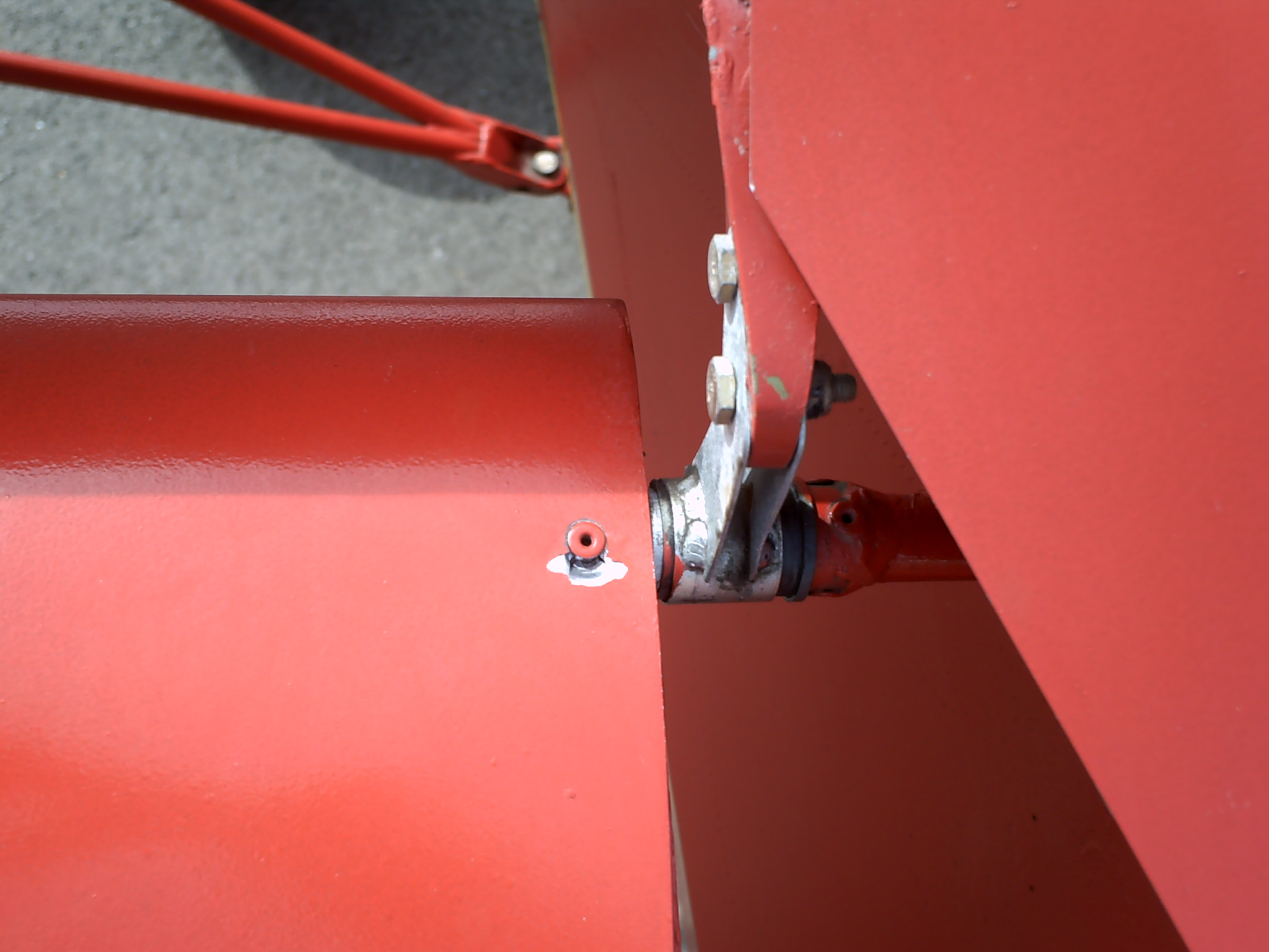

PostPosted: Mon Mar 16, 2009 9:00 am    Post subject: Re: Flaperon Damage. Reply with quote
OK, Here are some pictures. They say more that I could ever say in a post. Smile
The last picure is just of the plane, with the new stripe I put on. Just vynal tape, but it looks good I think.
Andrew

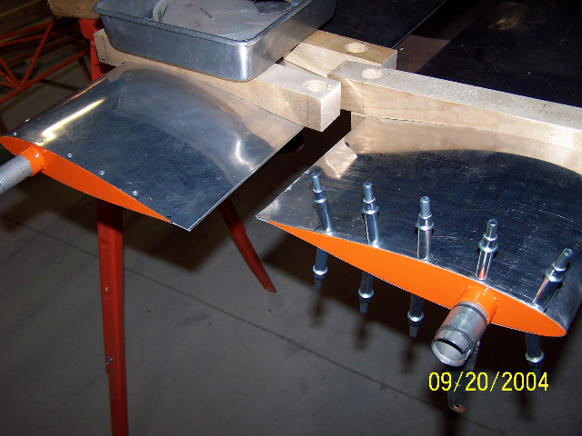

Lynn Matteson
Posts: 2778
PostPosted: Mon Mar 16, 2009 11:27 am    Post subject: Flaperon Damage. Reply with quote
Hi Andrew-
Here's what the later Kitfox (these are model IV) flaperons look like
in that area. Maybe you could have your repairman/yourself build a
similar "end rib" like this and pop rivet it into the end of the
flaperon. It would require removing some of the existing pop rivets,
and taking the bearing horn off temporarily, but that's no big deal.
Lynn Matteson

PostPosted: Mon Mar 16, 2009 11:40 am    Post subject: Re: Flaperon Damage. Reply with quote
little 5 minute epoxy on the foam and a quick aluminum patch (like you had described) and your back in the air in under an hour. You could even run the aluminum double inside the flaperon so all you would see is the rivet heads.
You can mix epoxy with micro balloons to make a nice fillet and you would never know on the end cap.

PostPosted: Mon Mar 16, 2009 12:05 pm    Post subject: Flaperon Damage. Reply with quote
Andrew,
Now that I have seen the pictures, your discription was pretty good.
This is what I would do:
I would remove all the foam and "Micro". (Micro is Lancairs name for epoxy
mixed with microballoons to form a very light weight "Bondo" like filler.
Drill out the rivet and scuff sand the surface of the flaperon. Then
fabricate the aluminum doubler and using a structural adhesive between the
doubler and the flaperon Skin, rivet it in place using several 3/32 rivets
around the periphery. Then re-rivet the doubler / skin to the spar.
Essentially, I think that is what your A&P wants to do.
When that is done, to close the end, bond some new foam into the inboard end
with epoxy and micro it to shape. - again Lancair vernacular.
Lowell
Lynn Matteson

PostPosted: Mon Mar 16, 2009 5:34 pm    Post subject: Re: Flaperon Damage. Reply with quote
Andrew, after seeing the pictures I agree your A&P has the fix figured out.
