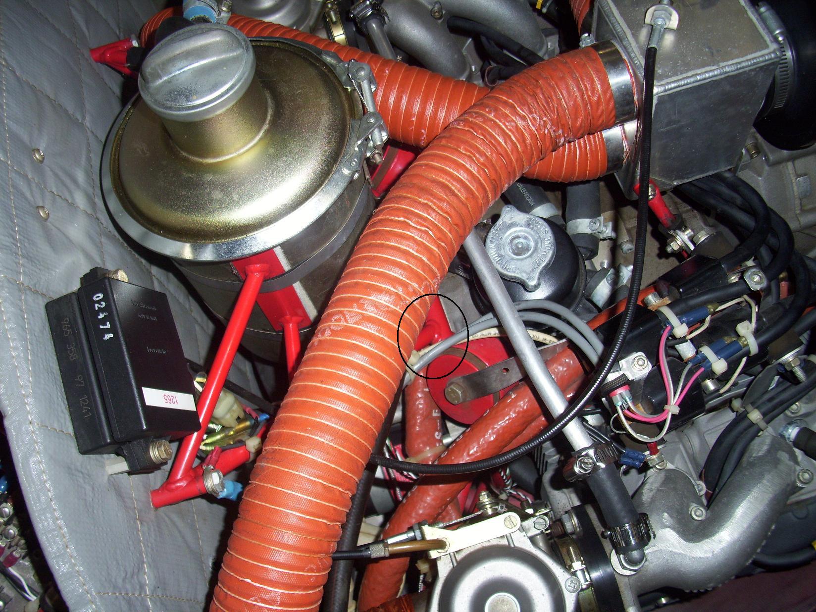

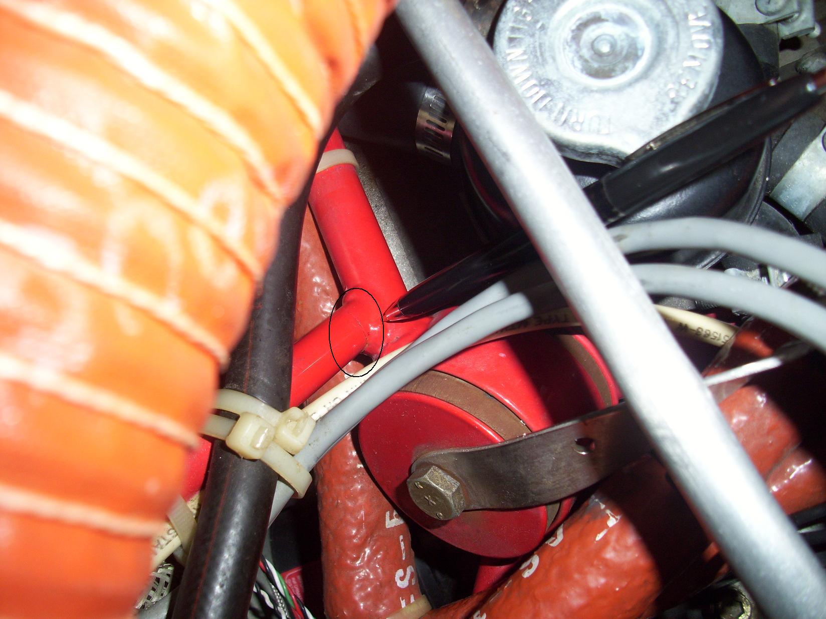

I wanted to pass along some critical information to the group. I have a Kitfox Speedster with a 1995 standard firewall forward Rotax 912UL (80hp). I found a crack 3/4 of the way around one of the engine mount tubes that go from the firewall to the "ring." Kitfox has an SB regarding cracks in this tube and require a gusset to be welded in to reinforce. Thing is, the SB targets the 912ULS (100hp) installation because of the kickback the engine gives during start-up and shut-down. I'm here to tell ya, the 80hp will crack it as well.
It's the tube that comes from the upper right (pilot's view) firewall attach point to the "ring." It has the right oil tank support bracket attached. It looks like the crack started in the lower, outboard quadrant of the weld seam by the "ring."
The red mount in the pictures are my mount. The yellow mount is the replacement Kitfox sells with a circle around the gusset and the area where my mount cracked.
If you have a 912 and the engine mount without the gusset, then inspect these areas carefully.

Theory aside, a 1 to 2 pound difference in props should not make a difference regarding a crack in a chromoly tube. Ultimately, I think it was a fatigue issue caused by a stress riser in the weld seam. It would have cracked eventually regardless of the prop.

The weld does come in pretty sharply at the toe on the bottom. The stress riser theory has alot going for it, and once the crack started it just propagated around the heat affected zone. One reason I make sure all the welds I visual and accept transition smoothly to the base metal.
