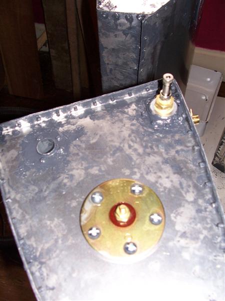

In fact, to find my slow leak I did have to submerge it. As much as I tried the soapy water just wasn't cutting it. Bill has a good point though, you won't be able to submerge the hole tank easily. I only had to submerge the seams I was inspecting under a few inches of water in my bathtub to find the leak. My tanks only had about 1 PSI air pressure in them, as I felt that anymore pressure would have damaged them. To pressurize the tanks i used a bicycle pump and a nozzle as used on bladder tanks (as in a house on well water). I'll attach a picture.
Dan

air nozzle purchased from local building supply store
 Filesize:  41.68 KB
 Viewed:  7610 Time(s)
