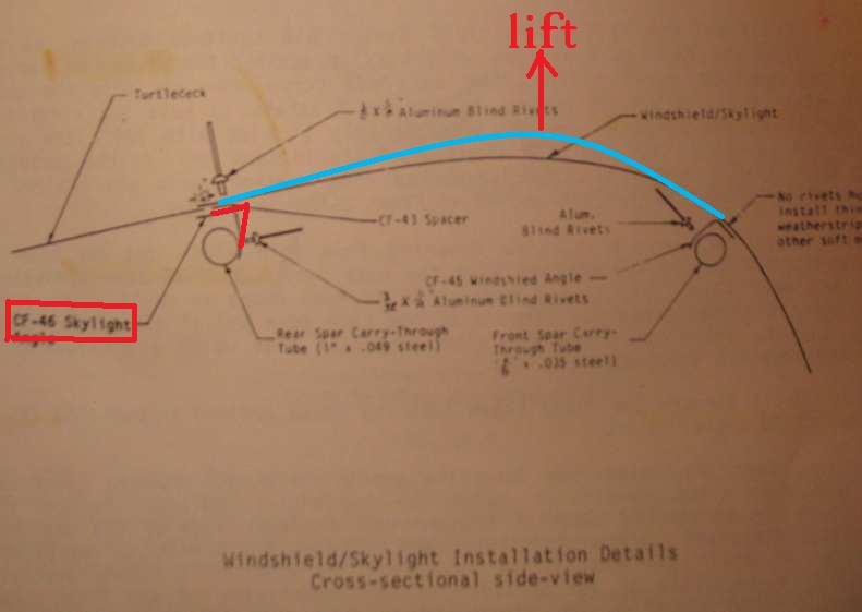

Lynn, I as well have started to question the competency of the builder of this plane. It is a fantastic plane but a few details just seem to be neglected. Notice the omission of the flaperon control horn bushing on the turtle deck. Unfortunately details like this are not apparent until you read the assembly manual. I am overall pleased with this plane but I suspect that over the years I will find a few things that upset me.
So now on to the turtle deck, I read the assembly manual and my turtle deck and wind shield appear to be constructed per the manual, which by the way only calls for a 1/4" overlap of the 'deck. This kit was purchased in 1990 and per the instructions there is only 7 DZUS fasteners. And there are stiffeners full length. What I found is that CF-46 Skylight Angle is flexible and can be moved forward. I have also noticed that nothing secures the green house to the fuselage and so in flight the lift over the fuselage pulls the window up and separates it from the root ribs, subsequently this shortens the overlap on the turtle deck. I believe that this may be what was the biggest contributing factor to the 'deck popping out.
So for now I am planning on doing the Avid mod. Any other observations or input is appreciated. Has anyone done anything to secure the lexan to the top of the fuse? I think that would be the greatest fix but I am not sure the lexan could handle it.

VERY good point, and one I did not think about. The first time I folded the wings, it was apparent that it was going to hit. I cut each side at about a 45 deg. angle and rounded the corners so it would not hit. GREAT catch!
Whurly, on my avid, it has a partial rib across the center of the skylight (greenhouse) that has rivets in it to keep the screen from ballooning up just as you have shown on the drawing you attached. May be an easy fix for you to add it if you so desire. I can get a good pic of how Avid did it if you are interested. The only drawback to it, is now I cant hang my head set over the center cross bar like I can on my Brothers KF II.

I think you have have just figured out where your flutter came from... without the bearing blocks in the turtle deck, I would put money on it that the flutter started right there. It is VERY specific in the Avid manual to put them in and not doing so can lead to flutter. It is also specific that it needs to be touching on the top not letting it flop around at all.

Omigod, yes, there should be fasteners all along the butt ribs to
hold the skylight/greenhouse down...at least on a IV, and I'd think
on a III as well. My plans call for:
"If you're certain it's positioned properly (square at the back edge
and .4" aft of the #52903 spacer), lay out, drill #30 holes and cleco
along the butat ribs using a 2" spacing 1/4" in from the capstrip
inner edge."
The #52903 spacer is the CF-24 spacer. So Skystar only allowed for
0.4" of skylight overlapping the t'deck. But the key to this whole
scenario is the screwing down, or riveting down, of the skylight/
greenhouse to the butt ribs. I can't believe this was not done. I
just re-read my instructions for mounting the windshield, and
although Skystar tells you to drill and cleco along the butt ribs,
they don't tell you to go ahead and actually do the riveting...DUH!
Again, I was concerned with all the problems that the group was
having with windshields cracking and crazing, and elected to install
nutplates and machine screws along the butt ribs. A
picture is below...this picture is rotated 90 degrees clockwise.
Another question, James....does your plane have the center rib? This
is called the #27005 Skylight Rib, and because it doesn't have a
corresponding CF-XX number, it may have been a Model IV and later
addition/option. This is just a support for the skylight as it is not
riveted to the skylight.
James
Kitfox 3 / 582 / GSC prop
4 hrs of instruction and climbing (I solo tomorrow)
 Filesize:  395.22 KB
 Viewed:  29501 Time(s)

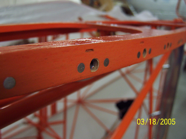

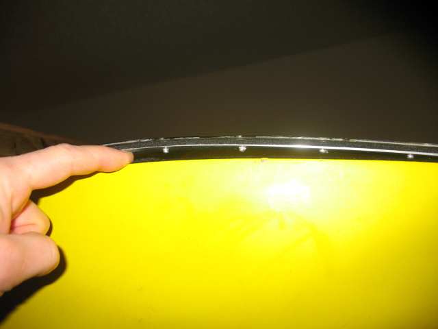

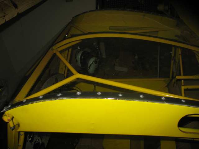

Again one of those things that you just don't realize unless you get to see a good KF example for comparison, and then there is the manual, which admittedly I misunderstood. As you can see in the pictures the green house is secured to aluminum strips along the top of the butt ribs. From top to bottom it goes; rivet, nylon washer, lexan, self adhesive felt strip, aluminum bar, other end of rivet. This sits on another strip of adhesive backed felt on top of the cap strip. There is a center rib but it is not secured to the lexan, it has a felt strip on it as well as per the instruction manual. i suppose this was the builders idea of making the window easy to switch out instead of using screws like you Lynn. It looks like I am going to be grounded until I can get a new piece of lexan. At this point I think if I completely replace the lexan and secure it properly I will be in good shape. I will probably increase the overhang a little since I will be replacing it anyway. Looks like the solo and rating will be waiting a little longer. This sucks but it will also give me time to get those bushings made and installed. And to think, we bought an already built plane so we could spend more time flying then building. Rolling Eyes
 Filesize:  28.5 KB
 Viewed:  29491 Time(s)
 Filesize:  19.23 KB
James
Kitfox 3 / 582 / 70" IVO 2 blade GA
50 hrs on the 582 swapping for HKS 700E and Avid Cowl.
Man that's weird. And I'd say it's definitely what caused
the lift. If your butt ribs aren't yet drilled you could probably get
away with re-using the skylight. Just set the Lexan down onto the
felt on top of the butt ribs and match drill. Be careful, though. I
had a lot of trouble getting the nut plates to sit perpendicular to
the skylight due to the way the butt ribs were made. There was a bit
of a fillet between the rib cap and rib. I had to Dremel a little
flat pad for each one. It was a real pain with the ribs already in place.
Guy Buchanan

Hey Lynn, are those 6-32 anchor nuts you used? How did you go about attaching them? I have ordered a new piece of lexan and I think it might be best to attach it like you did since if i ever work out all the bugs I might keep this plane for a while.
James

Lynn Matteson
Posts: 2778
PostPosted: Tue Feb 17, 2009 10:01 am    Post subject: New issue, turtle deck security Reply with quote
I'm pretty sure they were 10-32's...yeah, way overkill...no wait, now
I remember why I went with 10-32's..(drum roll)....because the heads
were larger in proportion to the body size (of the AN-526 machine
screws), therefore I could open up the holes in the skylight to that
that LP Aeroplastics said they should be, and still be comfortable
that the head was going to be fully covering the hole. For some
reason...at that time...I felt that a 6-32 or 8-32 wouldn't do that.
I used the AN-526 machine screws and K1000 anchor nuts/nut plates.
This picture I sent yesterday shows the flat head AN426 solid rivets
that I used. I had to order about 20 5/32"...black...clecos to grip
the anchor nuts so I didn't have to use a bolt through the anchor nut
for temporary holding.
Lynn Matteson
Jabiru 2200, #2062, 605 hrs
Sensenich 62x46
New skis done and flying
