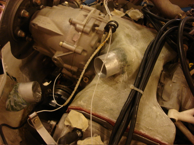

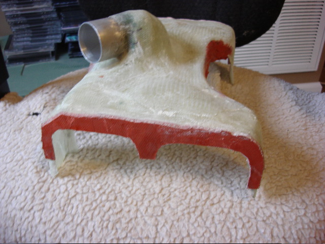

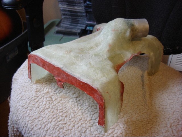

HI All,
After dealing with the uneven cooling issues under the Europa cowl, and
after looking at how all the new LSA planes are cooling the rotax, I
decided to make a cooling shroud or baffle as rotax calls it. I know
something like this came with some of the Kits but not mine. After
seeing the RV-12 at KOSH I decided to call Lockwood to see what one
would cost. We'll the rotax version was $900 + US dollars. So I got the
clay out and started making one. It turned out quite nice. All the air
from the right intake will be funneled up a 2 inch scat tube to feed
the thing.
After talking with Jeff B. of Baby Blue fame he thought it would be
nice if we could fashion a mold for anyone else wanting one. So before
I start the process I thought I'd test the waters on this list. Here
is a picture of it. Jeff & I thought if we made such a mold that we
could send it around to others wanting to lay up such a shroud. A mold
would be a lot easier than the process I went through to make this so
if you are interested let me know. Jeff gets first crack at it but we
could send it on from there. All interested parties please respond back
and we'll see what we can do. It seems to me that better and more even
cooling will make a happier engine.

rlborger(at)mac.com
PostPosted: Mon Feb 09, 2009 5:27 pm    Post subject: Cooling Shroud Reply with quote
Jeff R.,
You have a taker here! I'll be second in line after Jeff B. There
seems to be no problem with mine right now, but it's winter. I can
already see that one cylinder (#4 of course) is quite a bit hotter
than the others. So this is something I want to have in the back
pocket when the time comes.

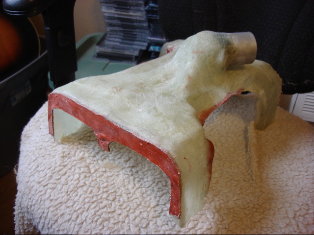

jeff(at)rmmm.net
PostPosted: Tue Feb 10, 2009 10:16 am    Post subject: Cooling Shroud Reply with quote
We'll guys. It looks like one or two are interested in this shroud so I
bought some plaster of paris and I'm going to attempt to make a mold of
some sort. I may have to make a negative mold out of the glass and
resin instead but we'll see.
On the issue of the mold melting I would suggest that if cooled
properly the slight amount of this that touches the fins shouldn't be a
problem. What I have done is where the shroud goes between the outer
outside and second cooling fin i used a lay-up of RTV and bid. You can
buy at any auto parts store the red RTV stuff thats supposed to be good
up to 650F. lay a 1" X 10 strip of bid on plastic. Start working the
RTV into the bid just as you would a regular lay-up. I went 4 layers
thick then on the last one I didn't work any RTV on the outside of it
just worked it into the previous layer's excess. This will allow you to
glue the one side of this onto the side of the shroud. After the lay up
add another piece of polyurethane just like when you made tapes of bid
in the build. You can then let it cure about a half hour trim it to
shape and glue it with epoxy to the side of the shroud. This will stay
slightly flexible and be the part that touches the motor most. I could
be all wet here but a good friend of mine made all his own baffling on
his EZ using this stuff and it's still working 800+ hours. Here is a
picture of the shroud off the engine so you can see what I mean.
I'll keep yas'all posted as to my progress on the mold. Hey maybe I
should just make a bunch of these and sell em;) After all I am a
capitalist! Let the bidding start!
Jeff R.
