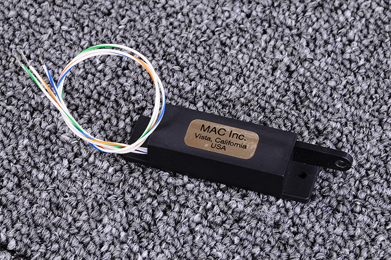

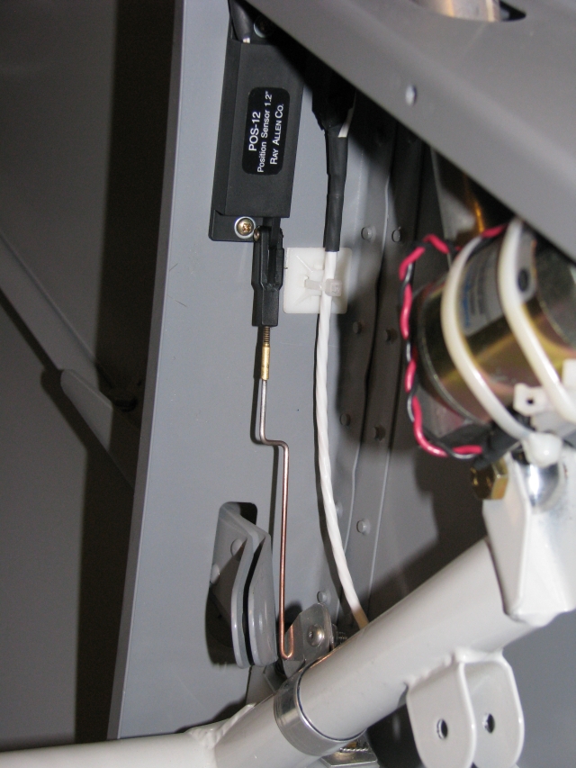

Does anyone have a simple, reliable installation design for the little position sensor from MAC Trim when used with the Electric Flap option on the PP QB RV-8? I've scratched my head for few hours now and have some ideas, but nothing that really seems like its simple enough or not prone to jamming. What have other builders done? Pictures would be great!

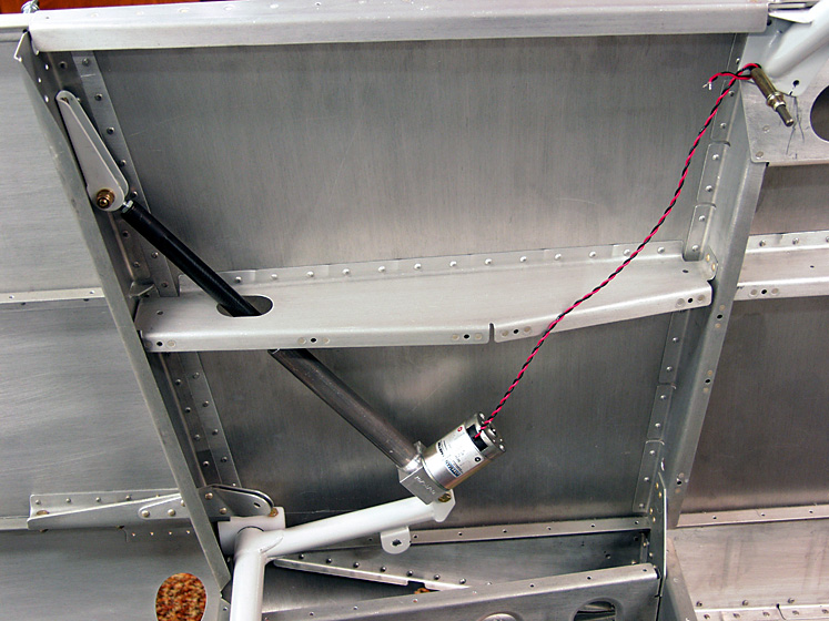

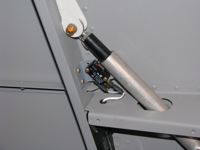

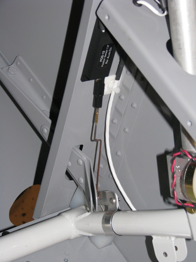

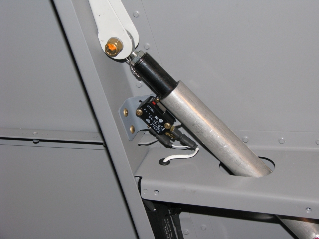

I just recently installed the flap position sensor in my SLOW build RV8. Like many before me, I just used a clevis and pushrod from an RC plane. I also installed a flaps up limit switch since I have a (ON)-OFF-ON switch on the stick.
