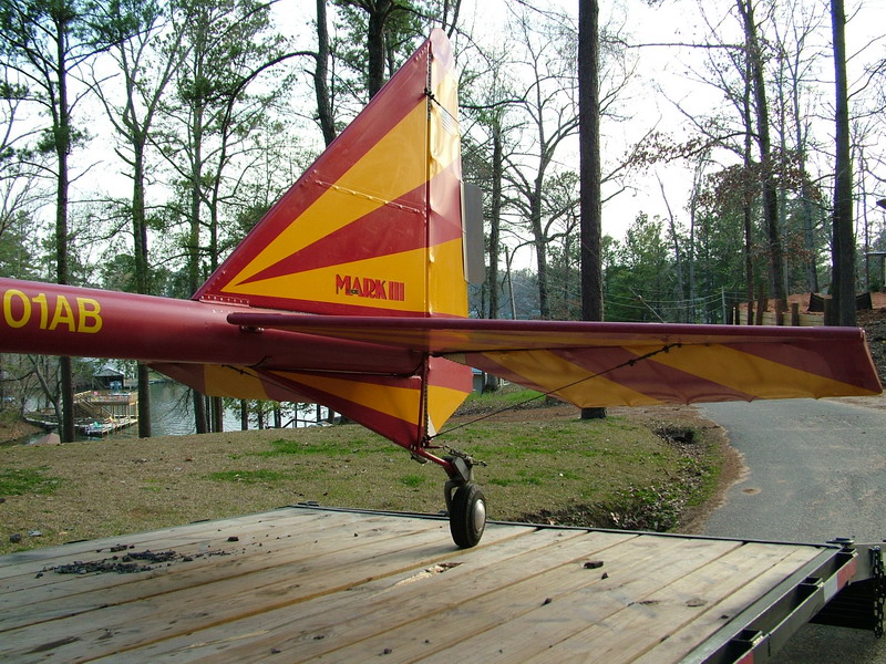

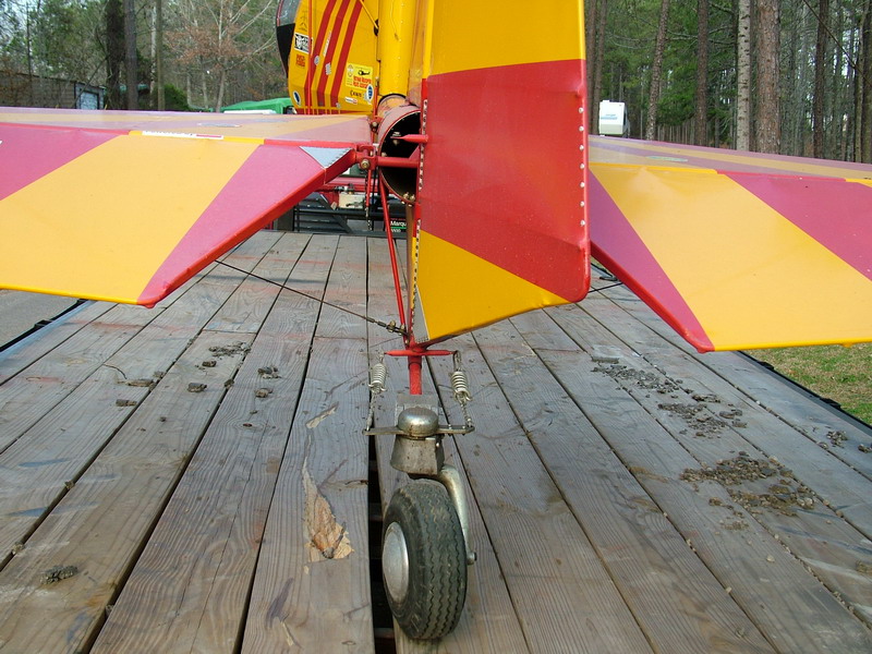

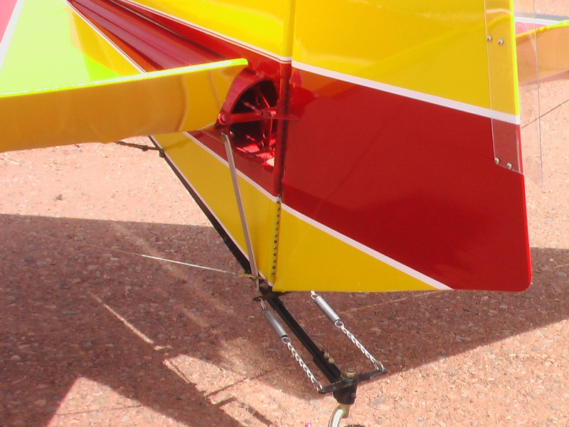

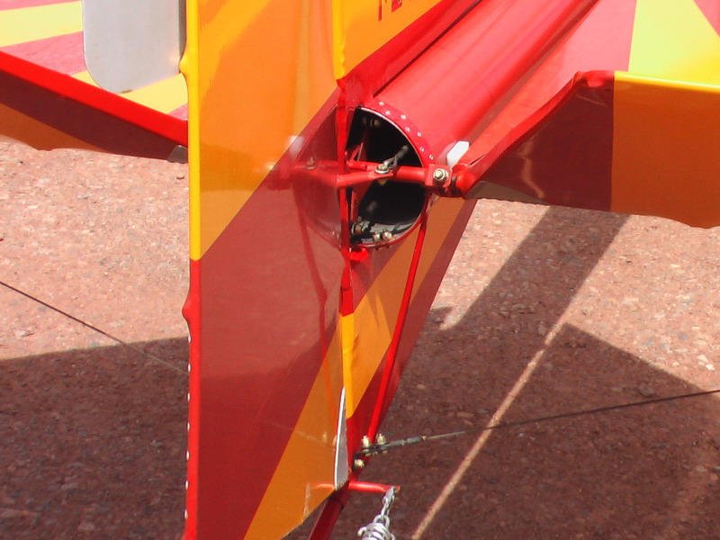

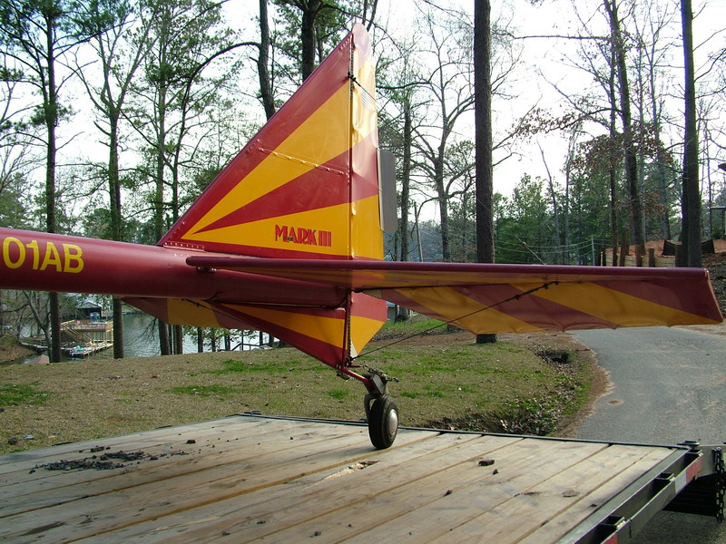

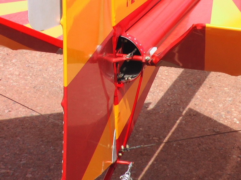

Here are a few photos of what I did, plus one that Gary Haley did with
aluminum strap.
I have some photos of my tail post after modifying and prior to covering.
If I run across them, I will post.

Dana:
The photo of the aluminum strap is Gary Haley's mkIII. I'm sure he drilled
out a rivet in the ring and a new hole in the lower vertical stabilizer
tube.
Dan Horton came up with the idea for the external braces on my tail post,
after several attempts at strengthening it with gussets. He ovalized some
3/8 or 1/2" 4130 tubes, we didn't have and streamlined ones, then welded to
the tail post ring and the bottom tube.
MKIII does not use tubes, rather a ring for tail post attachment.
Most folks think the wire bracing on the tail section is for bracing. Not
true. Their function in life is to keep the vertical and horizontal
stabilizers positioned. The only lateral bracing on the tail post is where
the top and bottom stub tubes are welded to the top and bottom of the tail
post ring. On the ground, especially without a full swivel tail wheel,
there are tremendous lateral loads placed on the tail post in the area of
the ring. Those two little external braces do a good job of beefing up
lateral strength in the tail post. I installed mine in 2004, after I
discovered the tail post had broken in two at the bottom of the ring. This
happened within days of my return from Alaska. I was very fortunate.
If I was flying an Ultrastar, I think I would got to 3/32" tail wires. I
flew mine with 1/16" wire, but that was 25 years ago. I lot of experience
has flowed under the bridge since then. I look at a lot of "stuff" quite
differently now than I did back then.

I like that... the same area has always concerned me on my US (especially
with the 1/16" tail brace wires), though I've had no problems so far. Was that an existing bolt in the tube or did you drill out one of the rivets?
It doesn't look like you have an "H" section inside the tube like the US, though, is this correct?
I'm also tempted to redo the elevator connection like that, instead of the US arrangement where I have to install the pin and ring every time I unfold the tail.
-Dana
Dana:
The photo of the aluminum strap is Gary Haley's mkIII. I'm sure he drilled out a rivet in the ring and a new hole in the lower vertical stabilizer tube.
Dan Horton came up with the idea for the external braces on my tail post, after several attempts at strengthening it with gussets. He ovalized some 3/8 or 1/2" 4130 tubes, we didn't have and streamlined ones, then welded to the tail post ring and the bottom tube.
Most folks think the wire bracing on the tail section is for bracing. Not true. Their function in life is to keep the vertical and horizontal stabilizers positioned. The only lateral bracing on the tail post is where the top and bottom stub tubes are welded to the top and bottom of [quote][b]
