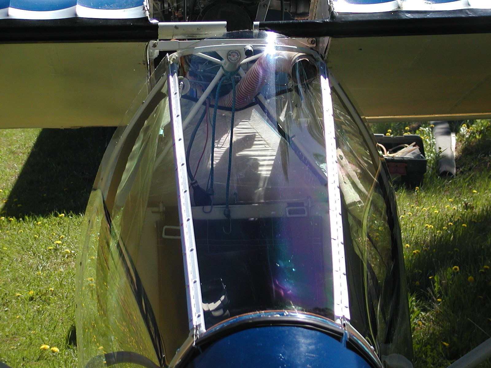

Larry Cottrell
Joined: 10 Jan 2006 Posts: 35 Location: Klamath Falls, Oregon
Posted: Mon Mar 20, 2006 9:05 am Post subject: Re: Firestar II Windshield |
I assume that you are talking about the factory enclosure. If so it will not buckle. To check it close the windshield, put your hand in the middle at the furtherest point from any support and push. If it feels squishey, don't do it. While I took out the center post, I did retain the screw that held it at the top of the pod. Remember the wind is not hitting it at a 90 degree angle. I have seen 90 on mine, but not on purpose. Or you could do it like this, it is a lot more trouble.
Larry, Oregon

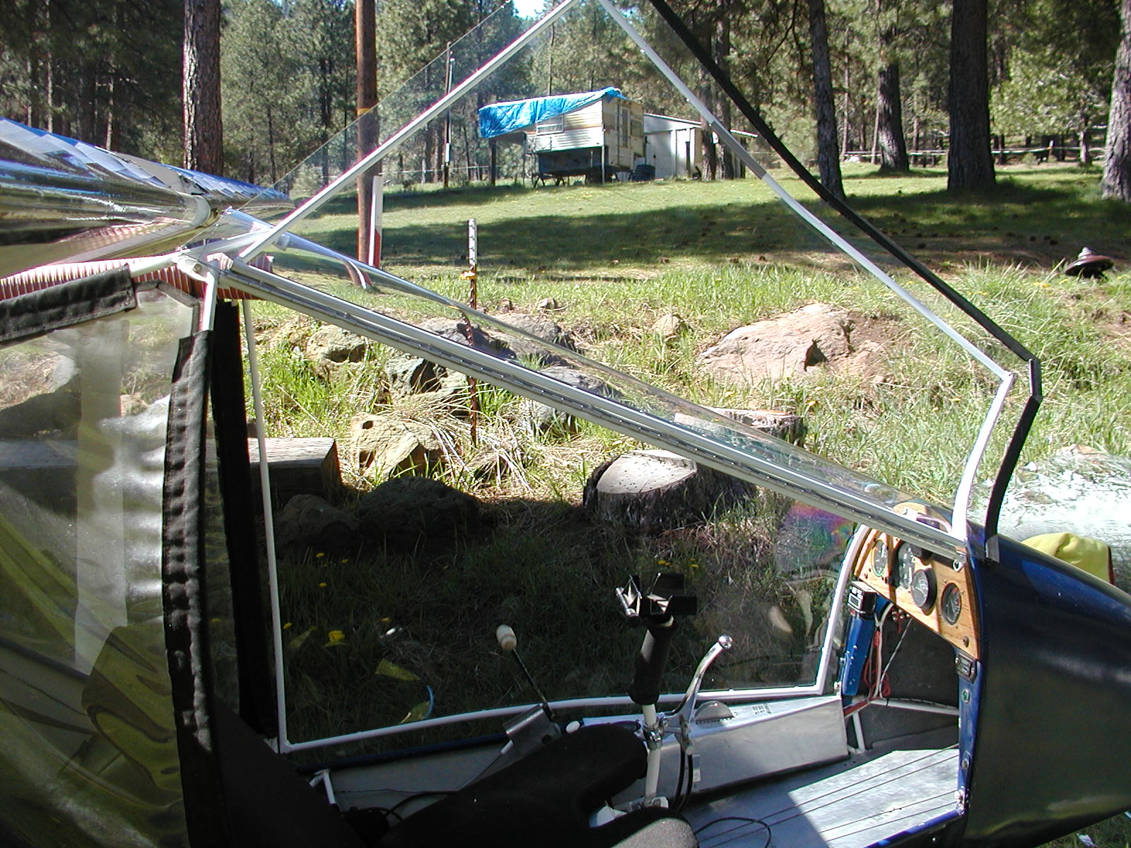

Larry Cottrell
Posted: Mon Mar 20, 2006 9:18 am Post subject: Re: Firestar II Windshield |
Well I see I still don't have the hang of the attachment part of this BB. I don't seem to be able to preview my post, and have to do it by trail and error. Seems mostly like error. Here is the other picture. I decided that I wanted doors, so I built this one. I of course had to order chromoly,hinges, and a sheet of lexan. Weld the new doors and fit the lexan. I like it, but I wasn't able to get the thickness of lexan that I would have prefered. (0 is too think and the one that I have is a bit too thin, but is still usable.
