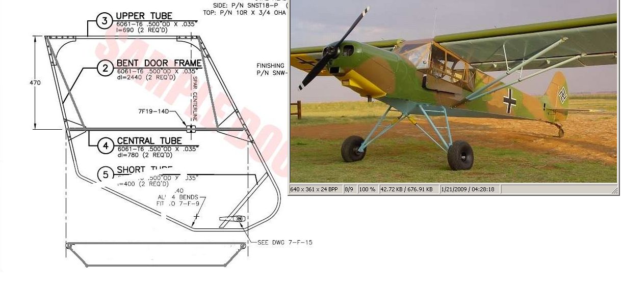

PostPosted: Mon Jan 19, 2009 4:23 am    Post subject: Re: Older Doors Reply with quote
Hi Tommy,
I found this through the wayback internet archives, it is a sample from the late 90s Zenith website.
Kevin
bubbled stadard door 7-F-19.pdf

PostPosted: Wed Jan 21, 2009 3:39 pm    Post subject: Re: Older Doors Reply with quote
Ok, here is my version of the old style door.
Maybe ugly but I don't like the totally clear bottom on the bubble ones, And this could allow for a sliding window and an elbow rest.
Kevin
