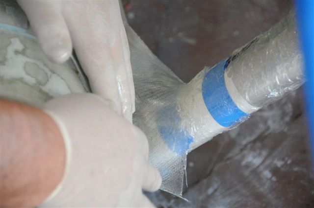

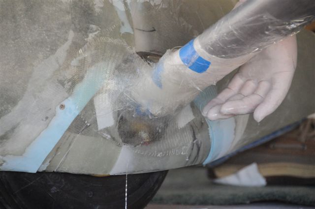

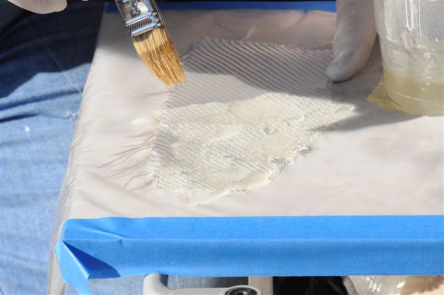

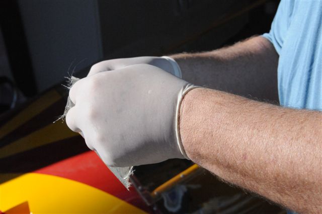

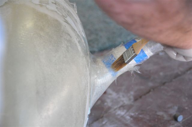

You can see the jogle I made on the back sidde of the pant with epoxy
filler and used seperator. Layed it all up, then cut the pannel around
the leg and removed the parts and finished them. Never tried this but it
worked quite well
