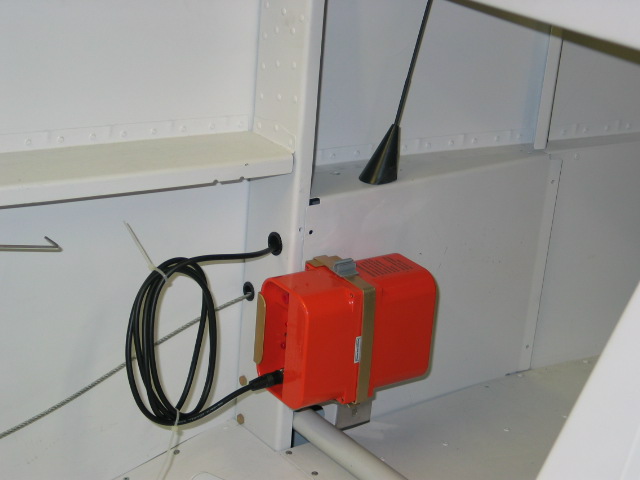

rv9jim(at)juno.com Guest
Posted: Sat Jan 17, 2009 2:40 pm Post subject: ELT location |
Carlos,
I have a "9" with the slider canopy. I mounted my "required" ELT
on the frame just behind the pass. seat. I use a Ameri king (the redish
colored one) and using the fame as the main mount, I ran the antenna back
through it and mounted it to the top of the cover that encloses the
rudder cable in the baggage compartment. This lets me remove the whole
unit easily if I need to in the future. Some day there will be a
reasonable 406 mz unit and I will put it in the tail cone behind the
baggage compartment. There are lots of problems with antenna placement.
First, there is a very good chance I will flip over. This places the
antenna under the airframe. The rudder will protect the antenna to a
point. That may break it off. I placed the antenna inside as my pix
shows. Not the best but it will work. The very low power of the
transmitter leaves much to be desired but its there. I have a PLB that I
carry in my survival vest. If I can get out or at least put the PLB out
side of the airframe, it has a built in gps so they can find me fairly
quickly. I hope that gives you some ideas.
Jim Nelson
N15JN
RV9-A

bicyclop(at)pacbell.net Guest
Posted: Sun Jan 18, 2009 10:39 am Post subject: ELT location |
James,
I tried last night but my message came through empty.
The way your ELT is mounted, the 'G' switch is oriented to starboard
instead of down. I think it would take a pretty unusual crash to
activate it. Mounted that way, it is unlikely to pass inspection, too.
You might want to rethink it.
Van's recommends and supplies kits for mounting behind the baggage
bulkhead to some pretty solid structure. That meets the ELT
manufacturer's specs and the FAA's as well. I know a guy who mounted his
to the baggage floor and zip tied the remote switch right too it. His
passed the DAR's scrutiny, OK.

We also kicked this around on the RV List in november. I don't have an exact link but I referenced the discussion here:
http://rvbuildershotline.com/archives/2008/20081122.html
The original question I had, however, wasn't so much about the unit, it was about the antenna. Many RVers tuck it around the rollbar, which seemed to preclude a decent ground plane to me (if I understand ground plane correctly).
The general consensus seemed to be, don't worry about it, it's not going to work anyway, which seemed an odd position for people who are so meticulous about the possibility of corrosion rotting their metal airplanes in record time or any of the other million things with little chance of happening that we obsess over. [Laughing]
Here's what I ended up doing, by the way.
http://rvnewsletter.blogspot.com/2008/11/installing-heres-where-my-remains-are.html
I had intended to run the antenna up a bulkhead support as indicated in that latter link and that have the antenna up top just afte of another bulkhead. Since then, i've bought a Dynon D100 and it recommends the remote compass in that same location. So now I'm wondering if the antenna will interfere with the th Dynon magnetometer?

Hi Ed,
Shoot, I'll have to look at it. My last bird mounted it the same
way (switches forward) but it was a different mfg. I assumed (bad me)
that the orientation would be the same. I don't have a lot of reason to
believe that this unit will be of any help. Its there for the DAR and
regulations. That is why I bought a PLB with GPS. If I'm alive, I will
remove it from my survival vest and turn it on. Even if I'm upside down,
I will break the canopy and stick my arm outside and run it. As a note,
I have a survival vest that I got from the U.S. Army during my 32 years
with them flying helicopters. It has a good survival knife, pocket for a
survival radio (my PLB) and lots of other neat stuff to keep you alive
for a while. A good fishing vest with pockets all over will do the same
thing. I should weigh it to see what it weighs as I think it is around 7#
=/- a pound or two.
Thanks again for the heads up.

Howdy Jim,
Yeah, the switches should be forward, but there is a side (the wide one)
which is supposed to face down. You're right, it probably won't save
your life no matter how you mount it, but you do have to get it signed
off. Good luck with it.
