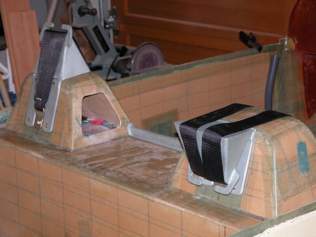

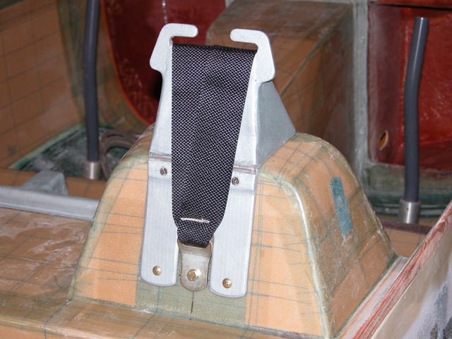

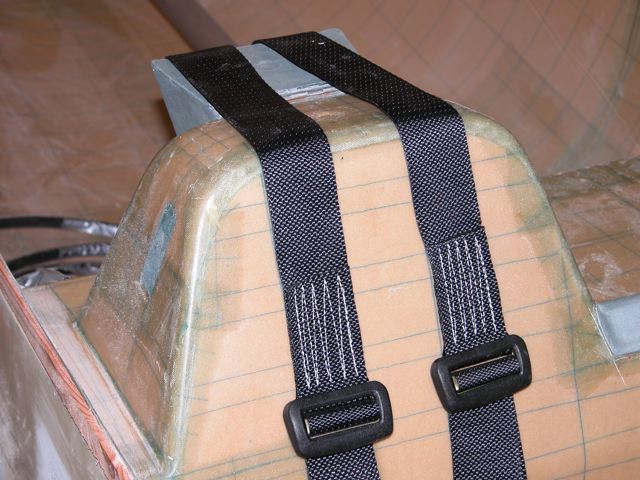

I share your concerns and gave the issue a fair amount of thought. What stopped me from establishing restraint points as you suggest were:
- the limitation of my own knowledge as to how much stress could be applied to the fuselage top shell, how it could be adequately distributed, and a concern that if it were ever needed, the result could break the back of Ms. Europa.
- a concern about dealing w/ potential side loads given the distance of such a restraint point from the seat back which might allow too much sideways movement of the shoulder harness,
- and a concern that whatever strap or cable might lead to such a restraint point could be bothersome when loading/unloading baggage, possibly requiring disengagement from the harness.
I settled on that little hinged riser (photos previously posted) because:
- it allowed for standard method of entering and leaving the cabin,
- all stresses could be routed to the CM as designed via the existing shoulder harness attach point,
- the riser could be bench-tested to ensure that it would not fail (in compression); I put what would be a tension force of 1500# in the harness at the appropriate angle and the little hinged riser absorbed it w/ no sweat; however, the force was applied incrementally rather than abruptly. I was figuring 100# upper body weight...so, theoretically, the riser may be good for 15G,
- and, when hinged back, it served to increase the area upon which one can sit while entering/exiting, and the approximately 4" x 6" area IMO only marginally reduced access to the baggage bay.
At the time I made mine, I actually bought enough material to produce a few "kits", but have set that notion aside as I've proceeded with my build. Incidentally, one aspect of this solution is that it allows the use of the standard harness and can be added at any time.
Fred

fklein(at)orcasonline.com Guest
Posted: Sun Jan 18, 2009 6:31 pm Post subject: Seat Belt Restraint Points |
On Jan 18, 2009, at 3:02 PM, JR Gowing wrote:
| Quote: | | Interesting information is coming. |
Bob,
Info to be revealed in due time?
| Quote: | | f you still have the folding seat details handy in your computer, I would be pleased if could email them to me so I can study it again. |
'fraid I don't use my computer for graphics...I'm one of those Neanderthals still drawing lines...here are a couple pixs:
Fred

It folding headrest arrangement now looks a hundred times better than I thought when I first saw it!
Especially since you mentioned how it increas the size of the sitting area when it is folded.
I understood that you are sending more info by some means so will be patient.
Posted: Mon Jan 19, 2009 9:19 pm Post subject: Seat Belt Restraint Points |
On Jan 19, 2009, at 7:30 PM, JR Gowing wrote:
| Quote: | It folding headrest arrangement now looks a hundred times better than I thought when I first saw it!
But if not then please tell me.
Bob,
I thought you were joshing me about the increase in size of sitting area...believe me, that was an unanticipated plus...the critical thing (at least to me at the time) was to not have to sit on a knife-edge!
Let me see if I can scan a drawing into a form which I can send to you, along w/ some add'l pixs....say, tomorrow, or the day after!
Cheers,
Fred

jrgowing(at)bigpond.net.a Guest
Posted: Tue Jan 20, 2009 7:05 pm Post subject: Seat Belt Restraint Points |
Fred
Don't bother trying to get up more pictures - I can see from the ones you already sent that I ought to do the mod.
What I need now is the plan/details -
and if anyone has already made parts to spare.
JR (Bob) Gowing UK Kit 327 in oz
