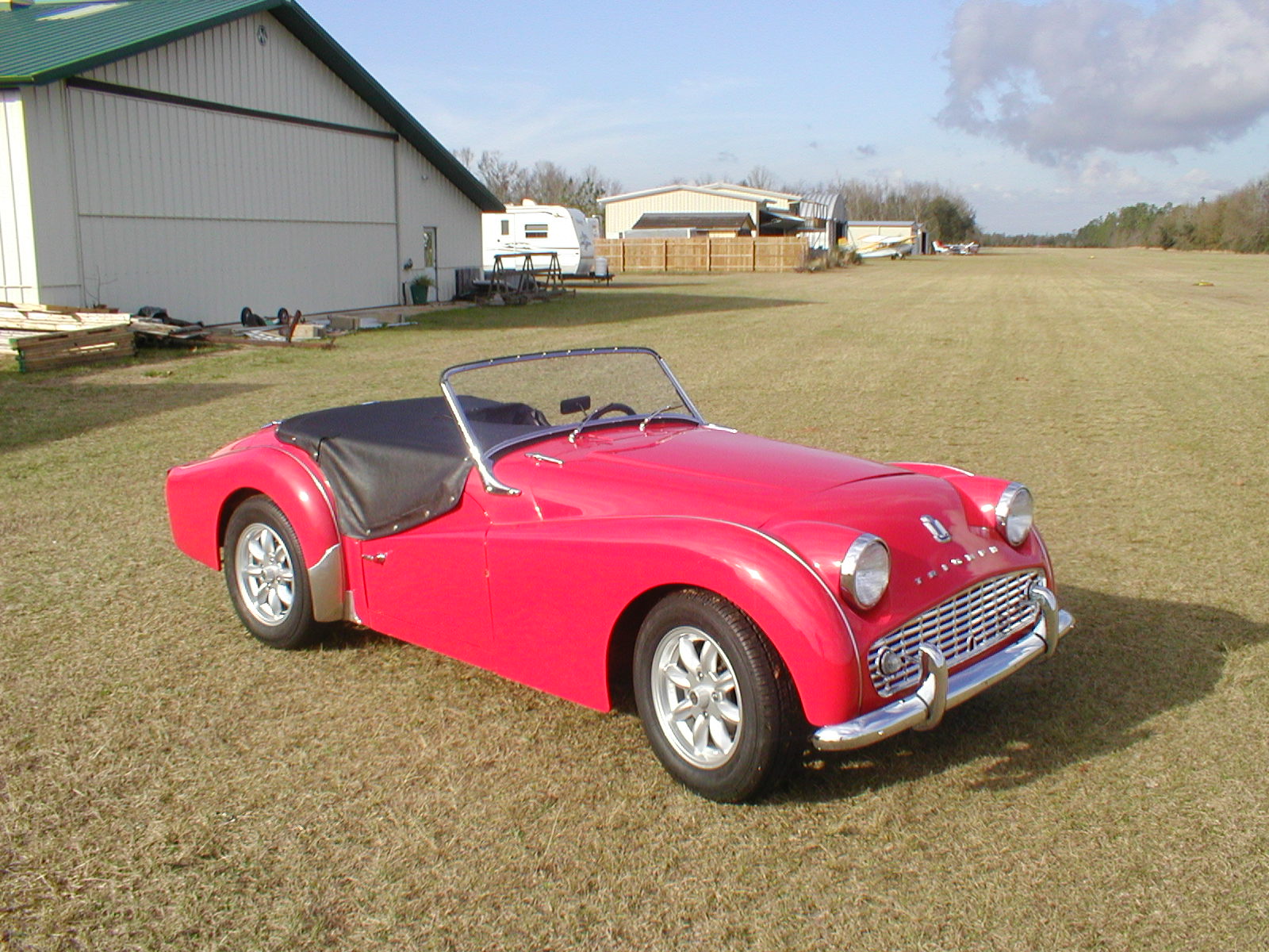

Triumph Tr'3s have never had Bing carbs ( they are SU H6) I bet you knew that was coming.
        Dick Maddux
        Pensacola,Fl

PostPosted: Fri Jan 16, 2009 11:03 am    Post subject: Bing Carbs Reply with quote
I think your Healey 3000 got shrunk... Beautiful machine!
Are the wheels original?
Noel

PostPosted: Sat Jan 17, 2009 4:56 am    Post subject: Bing Carbs Reply with quote
Thanks for your kind replies on my Tr3B.( I also have a "cherry " TR3A and a Stag) The wheels are Panasports and were offered as an option. And as you said the SU carbs are very close in function to the Bings. When I went through Rotax school at Lockwood we tore down the Bing carb and reassembled it. The Bing has more parts but its function is almost identical to the SU so it was easy to correlate.
          Dick Maddux
