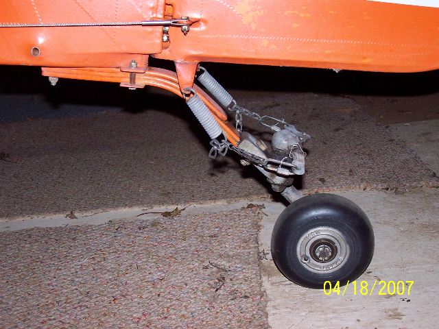

Charles
I just replaced my tail spring with the Kitfox 3 spring unit from John McBean.
I ended up only using the two large springs as the third made it a very rigid assy. I am not that happy with the new springs as they don't have the reflex bend at the end (My old ones had a slight upward sweep at the end to orientate the spindle of the Maule assy perpendicular to the ground).
The new one makes the spindle lay back at about 70 deg and this makes the assy unlatch extremely easily. In fact the once the assy unlatches the wheel wants to completely swing around.
Anybody else find this (Lynn?)

I haven't had any problem, but we don't know whether or not the shape
of mine is the same shape as yours...vendors often change things for
one reason or another. Here's a shot of mine...the triple-leaf McBean
spring. Notice how an imaginary line projected down through the
centerline of the spindle would hit the ground just ahead of the
contact point of the tire/wheel. This is so the wheel will castor
correctly, and mine does.
Gary, are you saying that your spindle projection points behind the
tire contact point? Or at it? Either case would cause what your
saying, I think.

I have the same problem with my tailwheel unlocking but I didn't attribute it to the angle of the spring until you mentioned it. I have to make very wide turns or the Maule tailwheel will unlock and around the tail goes ! It is a pain in the %$#& ! It is no problem on a hard surface but on grass it isn't much fun.

One of the things you need to remember about the Maule mechanicals is that, because of the way the cam action works, the looser the steering springs the easier it will break loose. Keep the slack out of them, they don't break loose so easily, and they're much easier to manage. I don't believe that the angle of the leaf springs has anything to do with the breakout. However, they can definitely be a factor on shimmy problems.
Of course, my opinion only. Tailwheels and their setup is a personal preference and there is probably no "right way".

That is what I to found out about my tail wheel..I put it together there
way.And I could not control KF2 on the ground..it would go around and
around.I could not do any thing about it..So I had to reshape the
springs with a press..And to my like it work out fine..Steve Shinabery

Lynn:
Are your rudder springs as loose as they appear in the picture or am I
seeing things...Darn glasses! Doh!
Noel

Lynn Matteson
Posts: 2778
PostPosted: Sat Jan 17, 2009 1:02 pm    Post subject: Tail wheel Reply with quote

Yes, they are exactly that loose. I like them that way, as it lets me
dance a bit without anything happening, I guess. I've landed at all
sorts of strips across the country....grass, grass and rocks, paved,
concrete, Dekes : ), snow, ice, lakes...just about anything I can
think of, and whether it's just because it's how I got used to it
when getting instruction (instructor didn't said a word then or now,
and he sees it every time I fly over there to hang out/work), or
what, but it works for me. I've tried them loose like this and
tight....I've tried with the Maule anti-shimmy springs, the unequal
compression-type springs, and this seems to work the best for me. The
Maule anti-shimmy, just to give them their due, were installed before
I had even one minute of training in a tailwheel. I couldn't get them
to steer to the left, I think it was, so I took them off (free to
anybody who wants to pay for shipping) and haven't even thought about
them since. Apparently there is something about my setup that works
just fine for me and my style of landing and taxiing, so I'm leaving
it alone...and believe me my CFI is very outspoken about EVERYTHING,
so he would have slapped me up side the head if he thought there was
something wrong.

PostPosted: Sat Jan 17, 2009 3:31 pm    Post subject: Tail wheel Reply with quote
It's not the leaf spring angle, it is the axis of steering rotation that is the
problem. In elevation view from the side, it the lower end points forward from
vertical then it will be easy to move the wheel into a turned position because the
tail drops a little as it turns. The traction of the tire provides the returning
force. Consequently if this angle is too far forward you have potential for a lot of
shimmy. Shimmy can be reduced by using dissimilar safety springs.
If the axis of turning rotation points to the rear to much it will be difficult to
start a turn because that requires the tail to lift as it increases turn angle. But
the wheel finds it easy to return to the trailing position.
The ideal angle is vertical when the airplane is loaded to max gross weight and the CG
is the farthest aft part of the envelope. So, as Lynn has shown in his excellent
photo, the unloaded tail spring will show this axis slightly pointing forward.
The problems in operation occur when that axis is two far forward or too far back.
Forward makes initiating a turn easy but straightening back up more difficult and
likely will cause shimmy. Too far back and inducing a turn is difficult but it will
return to a straight trailing position easily.
Tail wheel release occurs when the caster angle is greater than 40°. When it is
released your rudder controls do nothing to steer the tail wheel. If your caster angle
is too far forward the tail wheel can easily kick out to the side and you have no
control. Matco has two release angle options, 25° and 40°.
Look at the pictures and description of the proper setup in this document. (pg 14-17)
<http://www.bowersflybaby.com/tech/Maule_Tailwheel.pdf>
This is a real nice writeup especially for Maule Tail Wheels.
One thing important to note from Lynn's comment and nice photo is that the angle of
the tail wheel spring is about 45% near the tail wheel mount. "This works well for
me". That is important in the tail wheel dynamics because when it bounces the caster
angle changes to the rear and the that favors the tail wheel to straighten up in a
bounce.
bounce.
