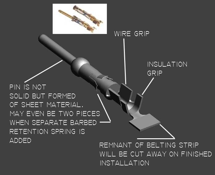

PostPosted: Tue Jan 13, 2009 7:10 am    Post subject: D-Sub connectors Reply with quote
At 08:43 PM 1/12/2009, you wrote:
--> AeroElectric-List message posted by: "Chris" <toaster73(at)embarqmail.com>
I'll second the compliment, I have learned so much about D-subs, when I saw the sheet metal type in mouser I kinda wondered and I can't say I have ever seen them in an actual application. SO machined it is!
Probably every d-sub connector in your computer
system is populated with the sheet metal pins.
These are most often supplied in very long strips
and coiled onto reels for application by automatic
machines. ASSUMING you have the manufacturing
environment to install these pins, they'll perform
as advertised.
We should also be mindful that just because a
pin is not machined from solid materials doesn't
place it lower in the connector food chain.
AMP MulitMate series of pins are an excellent
example of high-performance products manufactured
from sheet stock and well suited for high volume
production.
