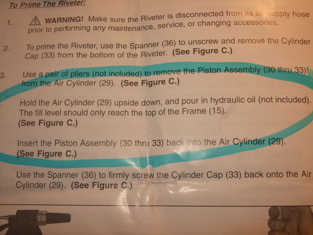

When I first started looking for a rivet puller, I shied away from the gun that
was being offered by Zenith because I had heard from builders on this List, that
there was many instances of cracking in the casings. As a replacement I decided
to go with a gun that was being offered by ACS ( see pic below ) however it is
starting to look like this was not my best decision

stepinwolf
Joined: 21 Jan 2008
Posts: 133
Location: Canada
PostPosted: Mon Jan 12, 2009 10:42 am    Post subject: Re: Need help & consuling on Rivet puller Reply with quote
Hi Fellows, I had not expected so much feedback, nor so soon, but I am glad to hear of all your experiences.
I must first apologize for mis-speaking earlier when I stated that the gun was purchased from ACS. I went through all my invoices, and found the Harbor Freight invoice ID'ing the gun. It is the Central Pneumatic model # 93458, and the exact same model however that ACS is offering.
As for the oil management, I have a very complete, ( and very expensive I must ad ) set of more then a half dozen " Chicago Pacific ) air tools, and like most of you responders, and few drops in the air intake, is more then enough to keep them in excellent shape.
However I had never used any rivet gun before, and followed the instructions that were given in the manual to the best of my knowledge, and hence the filling of the tool. Check the pic of the instructions in the user manual below.
This evening I will pour out any remaining oil, and give both of them another try.
Bob the 701 & 750 Scratch

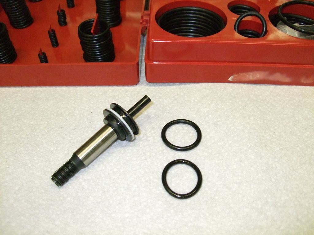

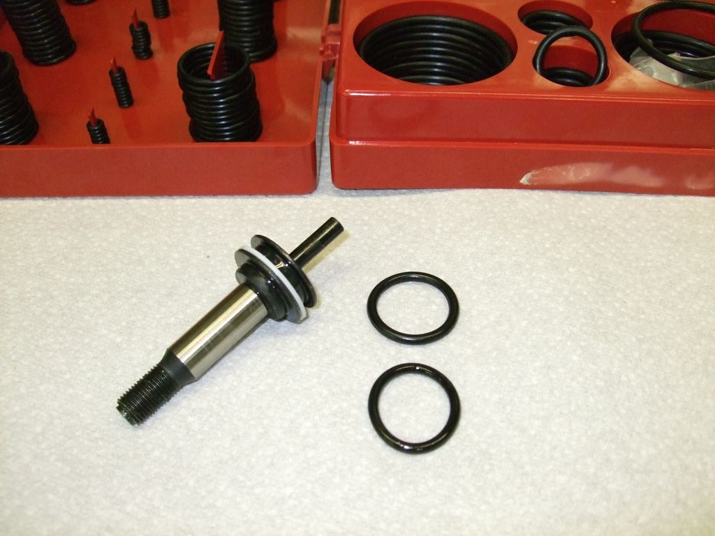

Terry, when I fill the piston stem opening to the top, no sooner that I re-insert the diaphragm into the gun, the oil comes squirting out the air exhaust hole in the front ( check rag ) of the canister or air cylinder.., and also out the rear into the stem holder.
I will also give this another try.

PostPosted: Mon Jan 12, 2009 10:47 am    Post subject: Need help & consuling on Rivet puller Reply with quote
Bob
I have the cheap HF riveter, and, for me, the instructions were not very
helpful. When I got it, I followed the instructions (at least I thought I
followed the instructions) to prime the riveter. But I did not understand
then what they meant by the top of the frame, and what I actually did was
lose the oil from the small diameter central cylinder that goes up into the
handle of the riveter, and add oil to the large diameter pneumatic cylinder.
I used the gun for at least a year like that, usually needing 2 to 4
trigger pulls to set a rivet (more for the A5's) Finally I disassembled the
thing and realized how it was designed to work. The oil in the small
central cylinder is the hydraulic fluid for the hydraulic part of the
"pneumatic-hydraulic" tool. That small cylinder must be filled with oil to
its top (assuming you are holding the riveter upside down). The large
(pneumatic) cylinder needs only a few drops of oil each day, much like you
must put a small amount of oil inside the cylinder of a bicycle tire pump
to seal the piston. Now, properly primed with oil, the riveter work fine.
One pull, one rivet set (and a bit of oil sprayed). I usually hold a
shop-grade paper towel when riveting to catch most of the oil. It's a good
tool. But the instructions were not very helpful.
If the oil spray is a problem for you, then you might be happier with some
other tool. And, yes, the rivet mandrel catcher only works well for me when
the riveter is used in the (rare) upright orientation. But the riveter
works well when it is primed correctly. And it will pull the AS5 rivets
without a problem.
The only other riveter I have used is a hand tool, so I cannot comment on
any other pneumatic riveters.
Terry

A big thank you to all who responded to my call for help.
Yesterday evening I was able to find, and correct the problem with my rivet gun. As was mentioned in a previous response, the defect was with the large O-ring on the piston at the top of the handle. it has an O-ring at the rear to seal the oil, and both guns had O-rings that were dried out and hardened.
This is why the gun was quitting after a dozen or so rivets, because the oil was leaking pass the O-ring into the stem catcher. Now it is working great, with no oil leaks.
There was however one casualty in all this and that is my second gun. While I was rebuilding the first one on the bench I casually pulled the trigger to check how far back the piston was pulling, and when it evacuated the air from the lower canister, it blow the spring from my second gun off the bench, and was never to be seen again.

Yes, now that I think of it, I did tighten those jam nuts twice, the second
and last time using lock tite on the threads. No problem since.
One other thing is until I learned to be sure the shaft of the previous
rivet was out of the gun, sometimes it would not close and grab the stem
until I made sure the stem of the previous rivet was out, either through the
backside or head.
