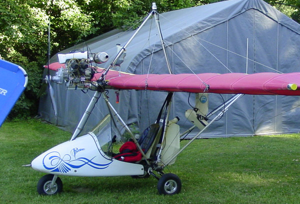

Thom:
Many tractors (Phantoms, Flightstar, MiniMax, etc...) use free air.
Added image of Phantom with free air and fiberglass scoop.

lucien
Joined: 03 Jun 2007
Posts: 721
Location: santa fe, NM
PostPosted: Mon Jan 12, 2009 7:28 am    Post subject: Re: Pressurized motors Reply with quote
Thom Riddle wrote:
Lucien,
That makes sense but have you ever seen a 503 DCDI engine without fan cooling? I've never seen one.
Yeah I've seen this on the Phantom. It requires replacing the fan housing with the one that doesn't have the fan on it and a free-air scoop in place of the regular cooling shroud.
The cooling is simply accomplished by ram-air from the prop and relative wind.
I believe the replacement housing is a rotax option, but the cooling shroud is a 3rd-party deal....
LS
