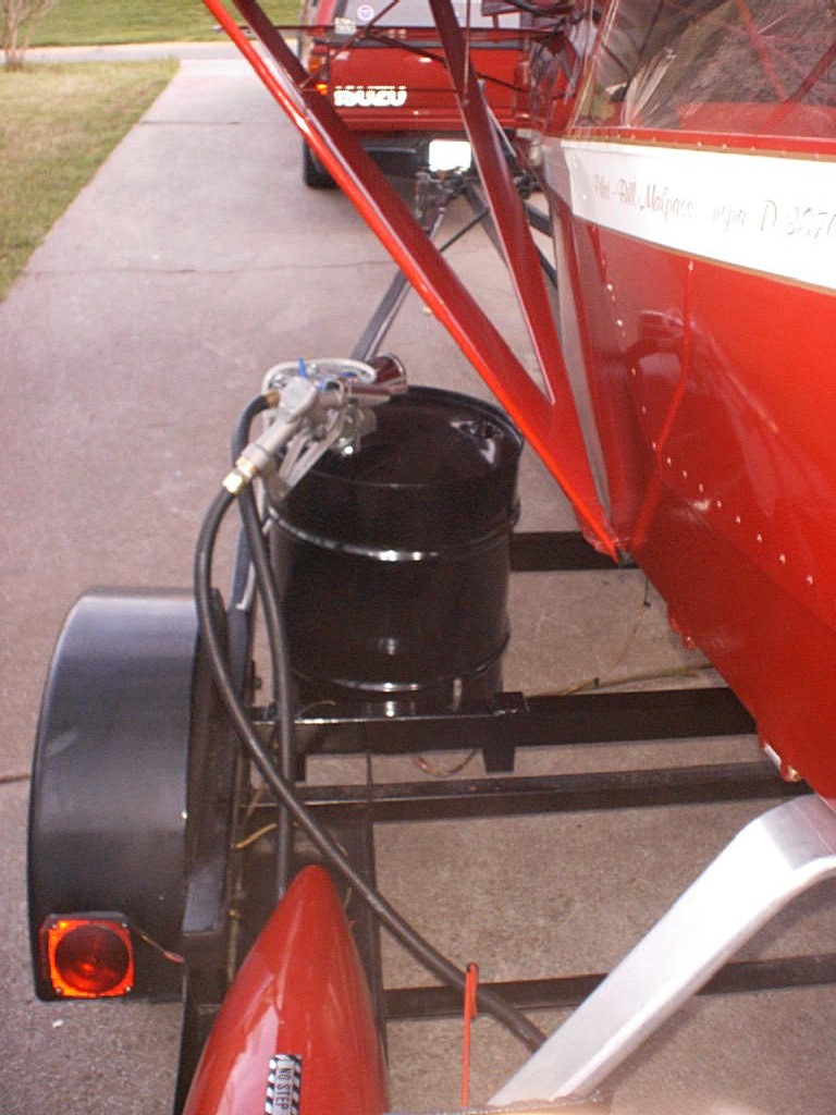

Since the subjects seems to be about ground transportation of the Foxes right now, I though I would share some info about what I did with my trailer.
The picture should show that a 18 gallon tank, DOT rated fuel pump (13 gallons per min.) and related welding for under 300 bucks. The concept really takes away alot of fueling troubles. Adding a 12 volt motorcycle battery mounted on the trailer allows stand alone independence from the auto. Coordination of the tank location is a key factor which will not hinder the loading and unloading of the plane. Prior to my creation, I had to use my 6 ft step ladder and 2 - 6 gallon containers of fuel (slow operation), and tiring.
Hope the pic makes it as this is my first time trying an attachment.
