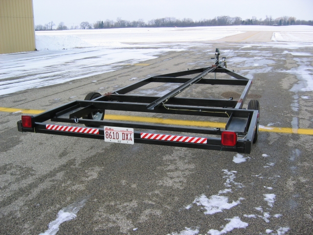

PostPosted: Fri Jan 09, 2009 1:37 pm    Post subject: Re: Trailering a Kitfox Reply with quote
By the way, here's one of the trailers I made. The center rail is
designed to elevate at the front to adjust aircraft attitude on the trailer.
And there is a swing open bar at the back,
Jeff
