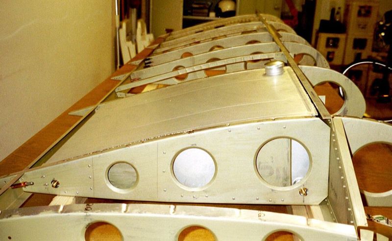

kmccune
Joined: 22 Sep 2007 Posts: 577 Location: Wisconsin, USA
Posted: Fri Jan 09, 2009 4:28 am Post subject: Re: 701 Wing Tank Question |
I was looking at my picks of wing stiffeners and realized that I had this pic, it sounds like what your describing for a 42.5 L or 11.2gal tank?
Kevin

jetboy
Joined: 22 Jul 2006 Posts: 233
Posted: Fri Jan 09, 2009 12:21 pm Post subject: Re: 701 Wing Tank Question |
Yes Kevin, similar although your pic shows 2 outlets and a curved upper panel probably more capacity and advantage for fuel flow when in sustained nose down ops.

ricklach
Joined: 20 Jun 2006 Posts: 127 Location: Kernville, Calif.
Posted: Sat Jan 10, 2009 9:14 am Post subject: Re: 701 Wing Tank Question |
Hi Kevin and Ralph,
The picture you posted Kevin is exactly what I want to build. I just can’t see wasting the area between the 10-gal Zenith tank and the rear spar. I also like the duel fuel outlets. Just like piper Pacer, Tripacers and Cubs.
