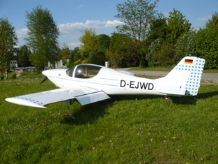

Dear All,
last November I bought D-EJWD, a Europa Classic Mono with Rotax 912 UL.
Since the headroom is definately not sufficient with cussions installed just thick enough for a comfortable seating position (for max. 2 hour-flights) - I am looking for those bubble doors I have seen on few UK-pictures on europaowners.org.
Where are they from? Did aerodynamics change with installation? Are there any other options of getting more headroom easily?
Thanks for a hint or two.
Frank Kusserow
Europa Classic Mono
Essen/Germany

kheindl(at)msn.com Guest
Posted: Sat Jan 03, 2009 5:17 pm Post subject: Bubble doors |
Try using a cushion out of memory foam. You must be very tall.

rlborger(at)mac.com Guest
Posted: Sat Jan 03, 2009 6:31 pm Post subject: Bubble doors |
Frank,
They were available from the factory as an option at one time. I don't know if they still are. Check with them.
Here in the States, the plexi was provided by LP Aero Plastics, Inc. That's where I had to go for my windows when Europa when bankrupt. I don't know if they would be your first choice as the shipping would probably be expensive. But if you can't find them anywhere else contact:

craigb(at)onthenet.com.au Guest
Posted: Sat Jan 03, 2009 6:35 pm Post subject: Bubble doors |
If you are totally commited to getting the extra head room with the bubble door "glass"
you might try taking the doors off and gradually and carefully heating the offending area with the door upside
down and allow it to sag under its own weight. then let it cool and replace the doors
Of course this approach would only give you an extra 20 to 30mm. This way if you are happy with the
result it has cost you very little, and if you wreck the "glass" then you can still go ahead and replace it
as you first intended.

grahamsingleton(at)btinte Guest
Posted: Sun Jan 04, 2009 3:08 am Post subject: Bubble doors |
craig bastin wrote:
| Quote: | If you are totally commited to getting the extra head room with the
bubble door "glass"
replace the doors
craig
You will wreck the Plexi if you do that. It reverts to it's "memory
state" when heated above 130C, ie flat but bent. It will shrink
Graham

frank(at)kusserow-online. Guest
Posted: Sun Jan 04, 2009 1:07 pm Post subject: Bubble doors |
Dear All,
thanks for the Ideas. I cut into the seat base today and found an inch or so
of styrofoam which I will remove before I get to the windows (because it
might still be not be enough headroom). I am 185 cm (73 inches) tall and up
to now I barely fit into the cockpit. Is that normal in the "Classic"?
Regards from Germany,
Frank
Posted: Sun Jan 04, 2009 1:25 pm Post subject: Bubble doors |
Frank,
There must be more foam or other packing in that seat area or
exceptionally thick seat cushions. I am 6 ft (72 in, 183 cm) tall and
I do not have any trouble fitting in my XS with standard Europa seat
cushions. I still have, at a minimum, another 2 in (5 cm) of head
space.
Work more with those cushions before you go to the trouble of
replacing the doors/windows.

budyerly(at)msn.com Guest
Posted: Sun Jan 04, 2009 4:33 pm Post subject: Bubble doors |
<?xml:namespace prefix="v" /><?xml:namespace prefix="o" /><![endif]--> Frank,
Contact Europa in the UK and we can arrange the bubble glass. I installed it in my first Europa. The glass is from LP Aero in the US. Cost was slightly higher than the original glass, but for you in Europe, shipping will be nearly as expensive. There is no speed penalty to speak of and no turbulence. I enjoyed the ability to look back farther and have another inch of headroom with my too thick cushions installed.
I now have a tri-gear Classic with original gold glass. I am 70 inches tall and it sounds like you have a high sitting height. Normally, leg room is a problem in the classic for folks of your height. Do follow the suggestions offered by the others such as: First, look to cut down the blue foam under the cushion flat with the torque tube cover running down the center of the seat floor. Then, remove the rear cushion and see how the headroom is. You can gain a lot of comfort by leaning back and making the back cushion thinner. My lower cushion is only 1.5 inches of foam hollowed out in the area where I sit to about 1 inch. How I do the hollowing out is open the lower cushion and carve out some of the foam from the bottom of the foam pad until I get my butt where it needs to be and still have adequate tailbone cushion. Be sure to leave the upper part of the foam cushion intact, so when you get out of the plane, the cushion springs back to shape. My back cushion is 1 inch at my back and to the top of the headrest. Where the seat back area goes vertical to the floor near the pins my cushion fills the void and bows out to fill the gap in my back and give lumbar support. This gives me nearly 2 inches before my head hits the glass, if I lean a little right, nearly 4 inches of head room. Finally, a headset with the thinnest pad is a must for a guy as tall as you.
Enjoy your plane.
Posted: Sun Jan 04, 2009 4:49 pm Post subject: Bubble doors |
Frank Kusserow wrote:
| Quote: |
<frank(at)kusserow-online.com>
Dear All,
or so of styrofoam which I will remove before I get to the windows
(because it might still be not be enough headroom). I am 185 cm (73
inches) tall and up to now I barely fit into the cockpit. Is that
Frank
Frank
you might try sitting on a small bean bag, shuffle until it's
comfortable then have a look at the shape you need. The trick is to
achieve even seat pressure on the body. Racing cars fill a bag with pour
in place foam and let it set round the body. Has to be the right amount
though.
The problem is sometimes length of upper torso. Body length varies a
lot, You can increase space by moving the buttocks forwards, which will
raise the knees.
I did modify one Europa for a guy who was 77in tall.
Graham

air.guerner(at)orange.fr Guest
Posted: Mon Jan 05, 2009 3:39 am Post subject: Bubble doors |
Frank,
I suggest you also try to put more cushion on the lower back of the seat to get a more reclined position. The upper portion of the seat back should be as thin as possible. Moving your bottom forward will increase your head clearance. However this will also reduce your leg room.
Remi Guerner
