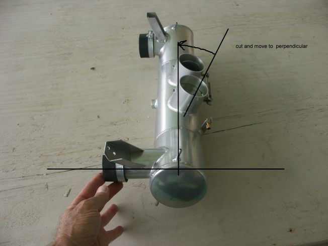

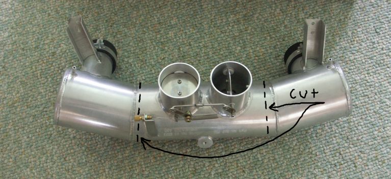

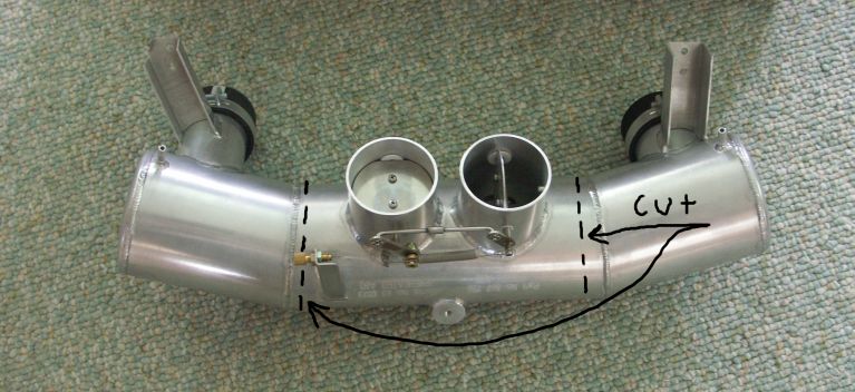

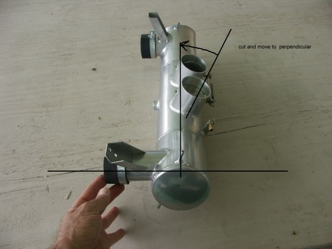

PostPosted: Thu Dec 25, 2008 11:19 pm    Post subject: Rotax carburetor heat for sale Reply with quote
You do know that in the old Skyshop FWF with the bedmount that they modified
the air box. They sliced the center section out and rotated it to make the
hot and cold air inlets vertical. Presumably they did this to make the
airbox fit in a 701.
Pictures attached, hopefully.

Tommy I should re state that. It is the Zenith FWF mount that attaches to the ring mount. The two upper arms do not allow for the heater box to sit down and align with the carbs. I don't think there is any way to modify it to fit.
If anyone knows a mod to make it work? With the bed mount the upper arms are at sharper angle and allow for the installation.

Mike did you take a look at the pictures Craig uploaded about modifying the air box? I wonder if that would work in getting it to fit?

I'm going to take another look at the air box to be sure it cant be modified.
