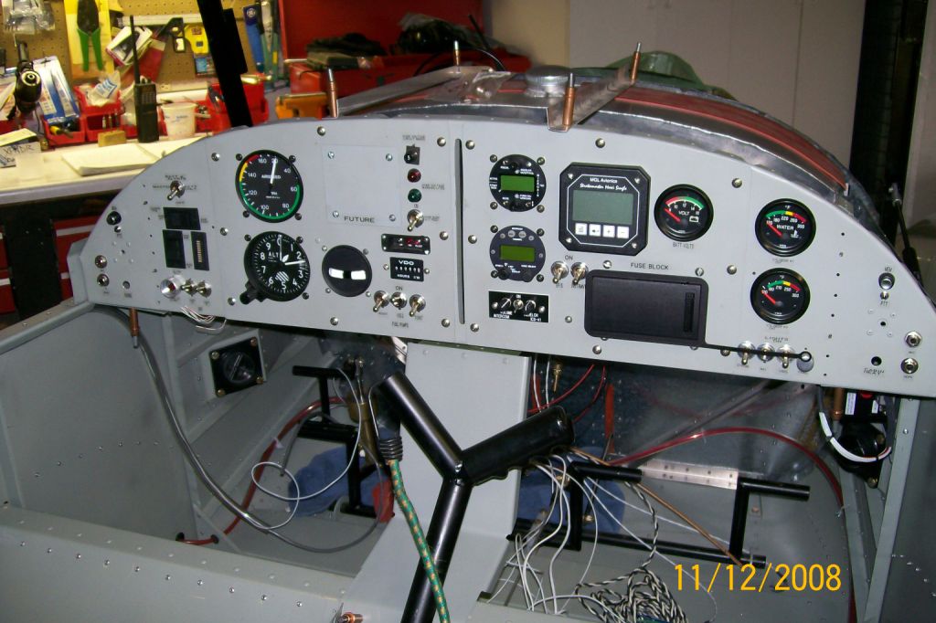

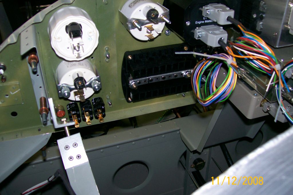

jlatimer1(at)cox.net
PostPosted: Fri Dec 26, 2008 8:49 pm    Post subject: Gettin' close Reply with quote
Bill,
This is what I did. I found a fuse block that had the feed wires in the
back and fuses in the front. It has two buses and is smaller than the
fuse block sold on the B&C Specialty web site.
Just another option.
Jerry
