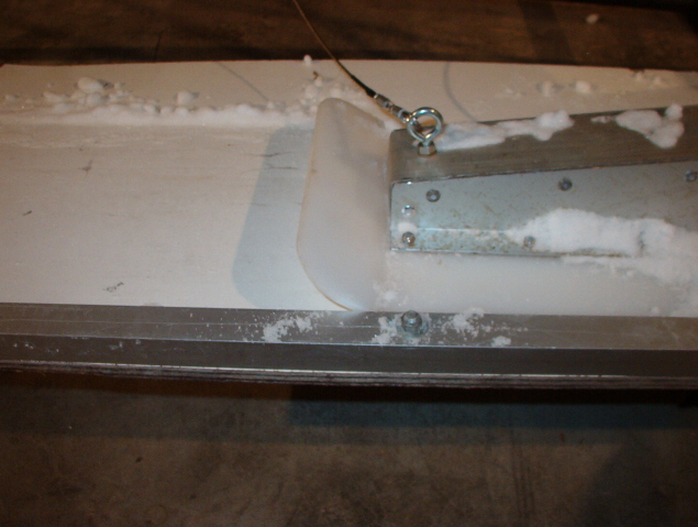

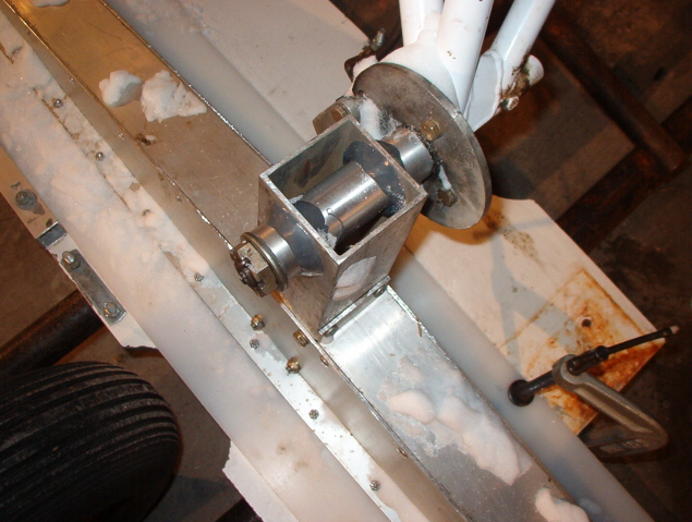

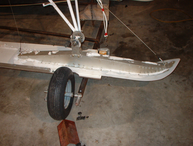

Hi all C I suppose I should post pics of my ski design also C they are just straight skis C no wheels. I've made 6 sets like this for different planes. If anyone is interested C I would be glad to give details on their construction. Bottoms are 3/16 UHMW. Take care C and enjoy winter!! Jim Chuk Avid MK IV flying C Kitfox 4 building (still) MnSend e-mail faster without improving your typing skills. Get your Hotmail® account.

Hi Lynn C Can't say that I have C although perhaps I did end up with some without realizing it. I bought a 4'X10'X1/4" sheet from a local supplier. Someone else picked it up for me and although it seems a lot like the UHMW C it doesn't slide as well as the UHMW does. It did work though C I used it on 3 different pairs of skis I built. I really noticed how it dragged when I was takeing off from a lake last spring with my 220 lb son. The snow was melting and sticky C and I was beginning to think we weren't going to get off the lake C and then we had to clear a hill with tall trees. We made it though C but this new set of skis are 3" narrower and have the white UHMW and they slide better than the old ones. I put 4 more landings on these skis today C it was about +5 F and I flew for a little over an hour. Take care C Jim Chuk Avid MK IV Mn

Hi Marco C The sides of the skis are made from 1/8" X 4 1/2" X 1 1/2" aluminum angle. The post that the axle goes into is 2 1/2" X 2 1/2" X 1/8" al. tube. I used a 1 5/16" hole saw to drill the hole for the 1 1/4" OD X 1/8" aluminum pipe and used structural epoxy to glue it in place. Some 3/4" gray plastic electrians conduit will slide tight into the 1 1/4" pipe and then it will fit your 3/4" axle. The top of the skis is more 2 1/2" tube cut into 2 channels on a table saw C or you could just buy some 2 1/2" X 1" channel. The bottoms are fastened on with #6 X 32 flat head machine screws. I do have a 1/4" X 1 1/2" X 18" UHMW runner on the bottom of the ski C without it it takes about 3 times as much room to turn around. The bend on the front of the ski is made by laying it out in 1 1/4" segments C and then cutting out a 5/16" to nothing wedge at each segment. Where the bend starts C the ski is 3" high. I used a propane torch to heat the UHMW to bend the ski bottom at the back end of the ski. I should have made a sketch with dimentions on it and posted it with this message C perhaps I can do that tomorrow. Hope this explains the skis C feel free to ask questions. Jim Chuk Avid MK IV Mn
