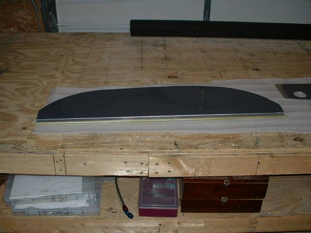

All-
This turned out much better than I expected, but I'm sure the procedure can be improved on by the next guy.
1. Materials were McMaster-Carr 8747K134 for the laminate. This stuff is listed as "Gray", but as you can see it's
only a step up from black. If I were doing it again I'd go for their "Off White". Adhesive was ACS 08-01026, which is
flat-out amazing stuff.
2. Before laminating the panel I experimented using extra laminate glued to .020 scrap stock. In my "Cuts"
attachment, the top sample used an HF fly cutter, the bottom a hole saw. Both were machined from the top and cut
clean with no tearing or fractures.
3. The stock was so shiny, I originally thought it was covered with a protective film ala the sheet you get from Wicks.
WRONG! I have unavoidable scuffs in the material, and it's too shiny for my liking. Consequently, I'm going to rub the
panel down with Dupont Polishing Compound just before final instrument installation.
4. I originally thought I would have to screw the panel/laminate sandwich down to my bench in order to get a good,
flat bond but it's not necessary with the ACS adhesive. I sprayed both the panel and the laminate, counted to 60 and
put them together. You have minimal but acceptable working time. After lining up and putting the pieces together
I rolled them out with an edging flooring roller. That's it!
The laminate adds enough strength to enable you to fearlessly drill your instrument holes and won't scratch like
paint. Added weight is negligible.
Good building and Merry Christmas!
Bill Naumuk
Townville, Pa.
HDS 601MG/Corvair 95%

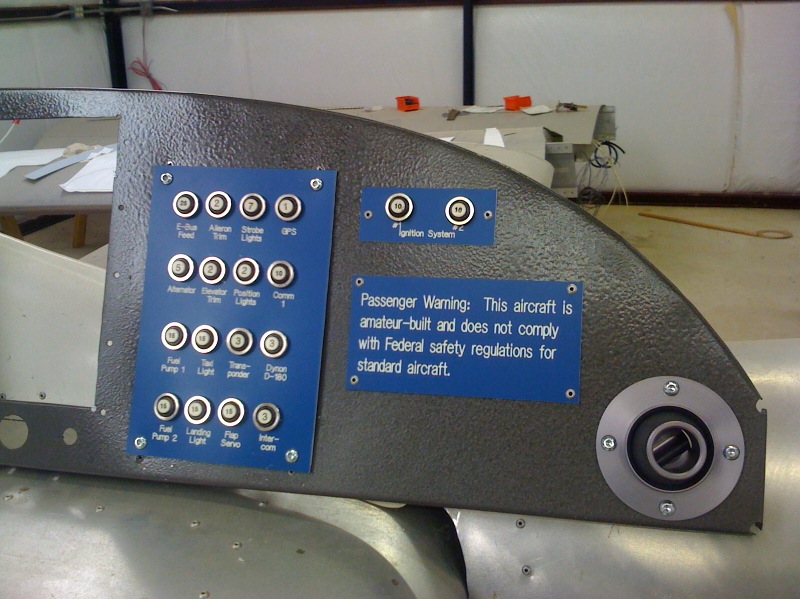

Since we are showing panel stuff here are some photos of what I did the last two weekends.
The panel is painted with RustOleum "Hammered" finish paint.
The circuit breaker panel will come out with 4 screws for service.
The eyeball vents are the ~$56 ones from ACS. One reason they are cheaper than all those $100+ versions is that you have to supply the collar for the air hose to attache to.
